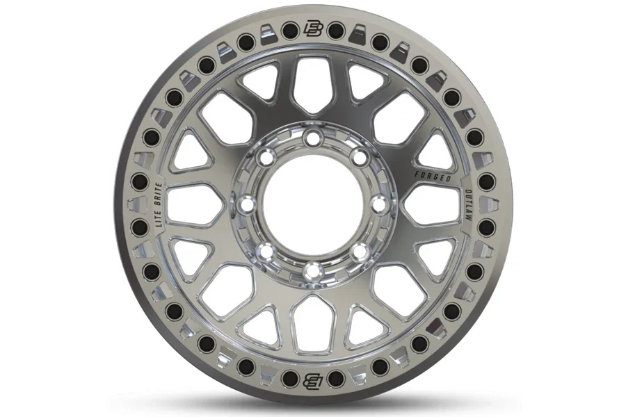

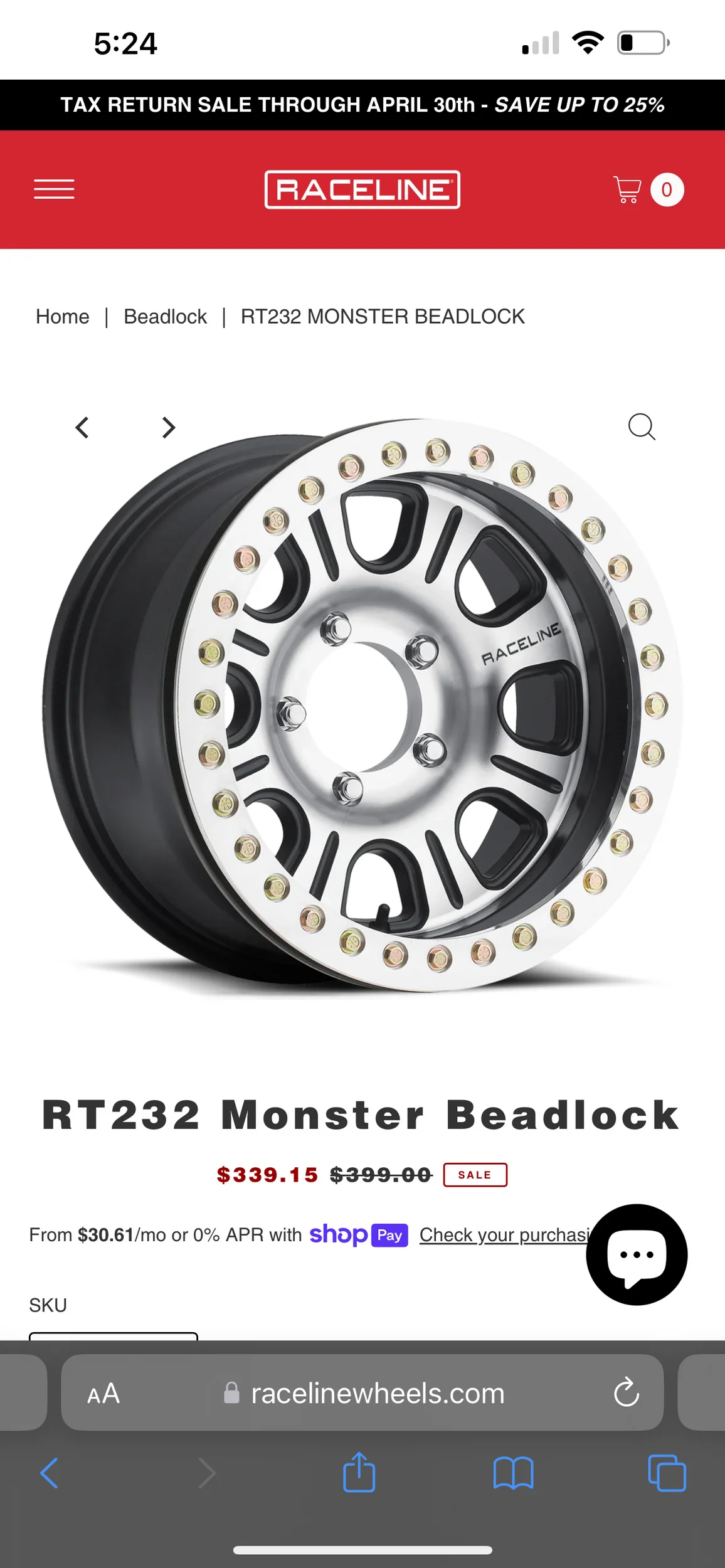

I’ve been looking for a while and found a couple I liked with tolerable backspacing. I really liked Battle Born Wheels but they were more expensive and 9” wide and I’d rather do 8.5” wide. I liked dirty life wheels but they were also 9”. Raceline Monsters look good and have tolerable backspacing. Trail ready wheels were seeming like an optimal choice because I could pick any backspace I want but damn they were expensive.
I’m going back and forth between all these options and I remember that 5 years ago I coached a good pole vaulter who’s family owns allied wheels who owns Raceline. I shot the dad a message and he said he would hook me up big time. That made the decision easy. The wheels haven’t gotten here yet but we ordered some raceline monsters in 17”X8.5” in 4.75” backspacing. That puts me at a net 3.875” of backspacing which is close enough to 4” for me. Plus my current 5” BS wheels are rubbing my anti rock and shocks about as hard as I’m comfortable with, so a smidge more room will be welcome.
