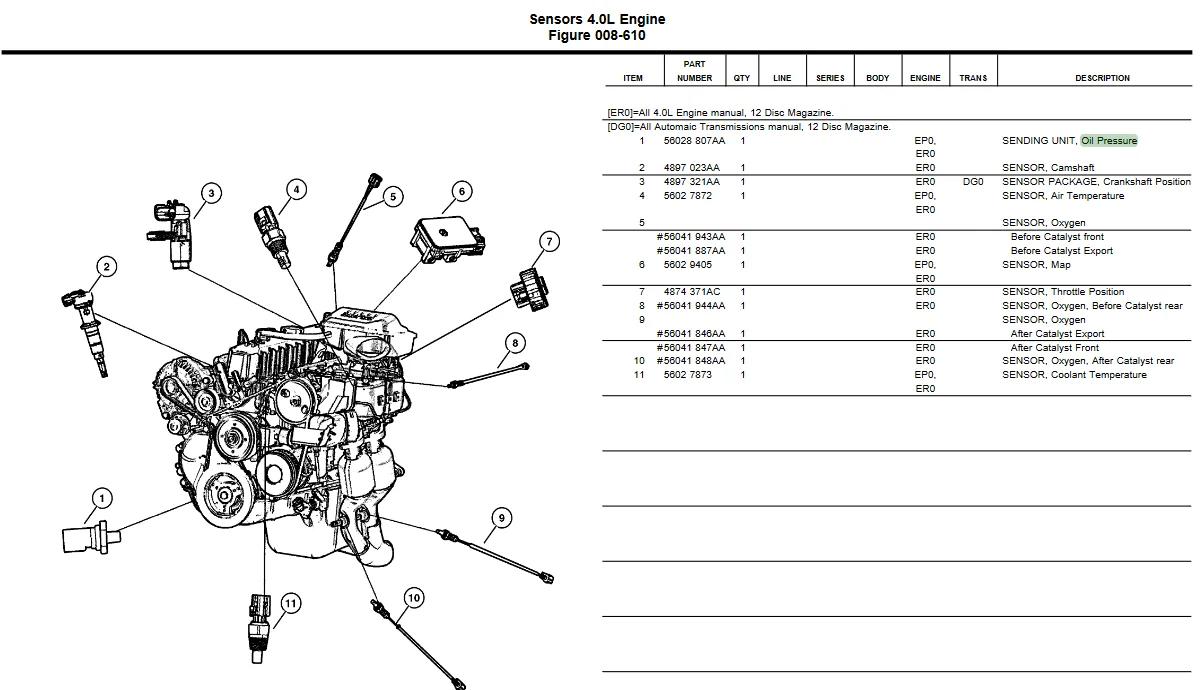

The usual problem is that it artificially reads 0, if it pegs out I would be wondering if the sensor was bad, or possibly if you got one for 05 or 06, where the wiring tends to change although I would need to actually check the wiring diagrams to see if the connectors would even allow for such a thing.
In our resources section we have the parts catalog for every year. Although depending on where you got your sensor from, it wouldn't be out of the question for the wrong one to be in the box. I have a handy reference for the wiring on this sensor, gimme a few to dig it up while I'm on this customer call.
