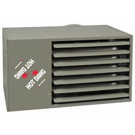

If he's in town, a NG heater is pretty inexpensive to install and to run. That's what I use...65000 BTU and I only bumped my gas bill by 30/40 dollars a month...and I'm heating a 24 x 30 two story barn with it.
as an example
Mine draws combustion air from outside too, so I don't have to worry about a big ka-boom! when I'm making fumes or doing anything that releases a lot of fine dust.
