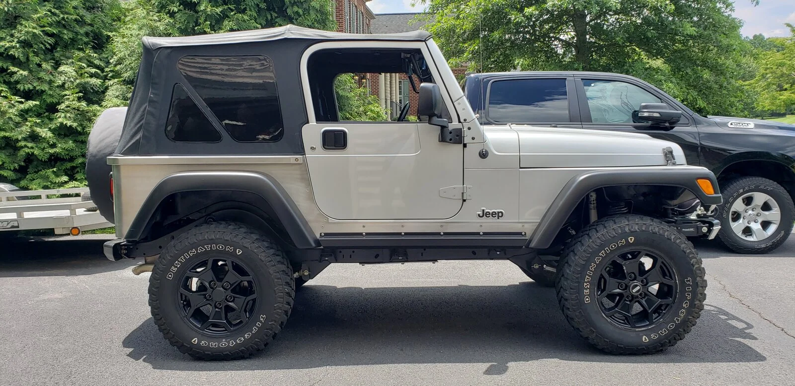

I’m loving what flux is up to but I was referring to the tub rail, as in the stainless steel bar that went into the top of corner armor to add as a slider in the back,
Like what @Irun has aswell as many other members. The only homemade version I’ve seen is @jjvw but I was curious if there was anyone else that has done it?
I’m loving what flux is up to but I was referring to the tub rail, as in the stainless steel bar that went into the top of corner armor to add as a slider in the back, View attachment 525690

@Alex01 fabbed a radiused set of rub rails. 😋
No, WA has wheel coverage laws. They’re ready to go when I wheel on the West side of the state where trails get narrow. I’m looking forward to it. I still prefer the rub rails over the GR flares.
Thanks this was the one I was looking for!!

I have the savvy rails. If I didn’t have them then I would probably just make a straight aluminum piece and not worry about the curve. I’m not sure my fab skills would let me get a very clean curve.
That’s where I’m at, the bend looks good but idk if I could pull it off
If the aluminum bar could be bent to fit the curve cleanly, we would see more DIY versions like this. The aluminum cracks. That is a reason why the Savvy rails were stainless and formed the way they are.
Makes sense, thanks for the info!!
The curve is not worth the hassle. I just ordered it long enough to attempt. The first side went pretty smooth and the second was a pita which ended with a crack. It was salvageable but nowhere as clean as a savvy bend.
Reactions: starkey480
Copy that, straight it is!
