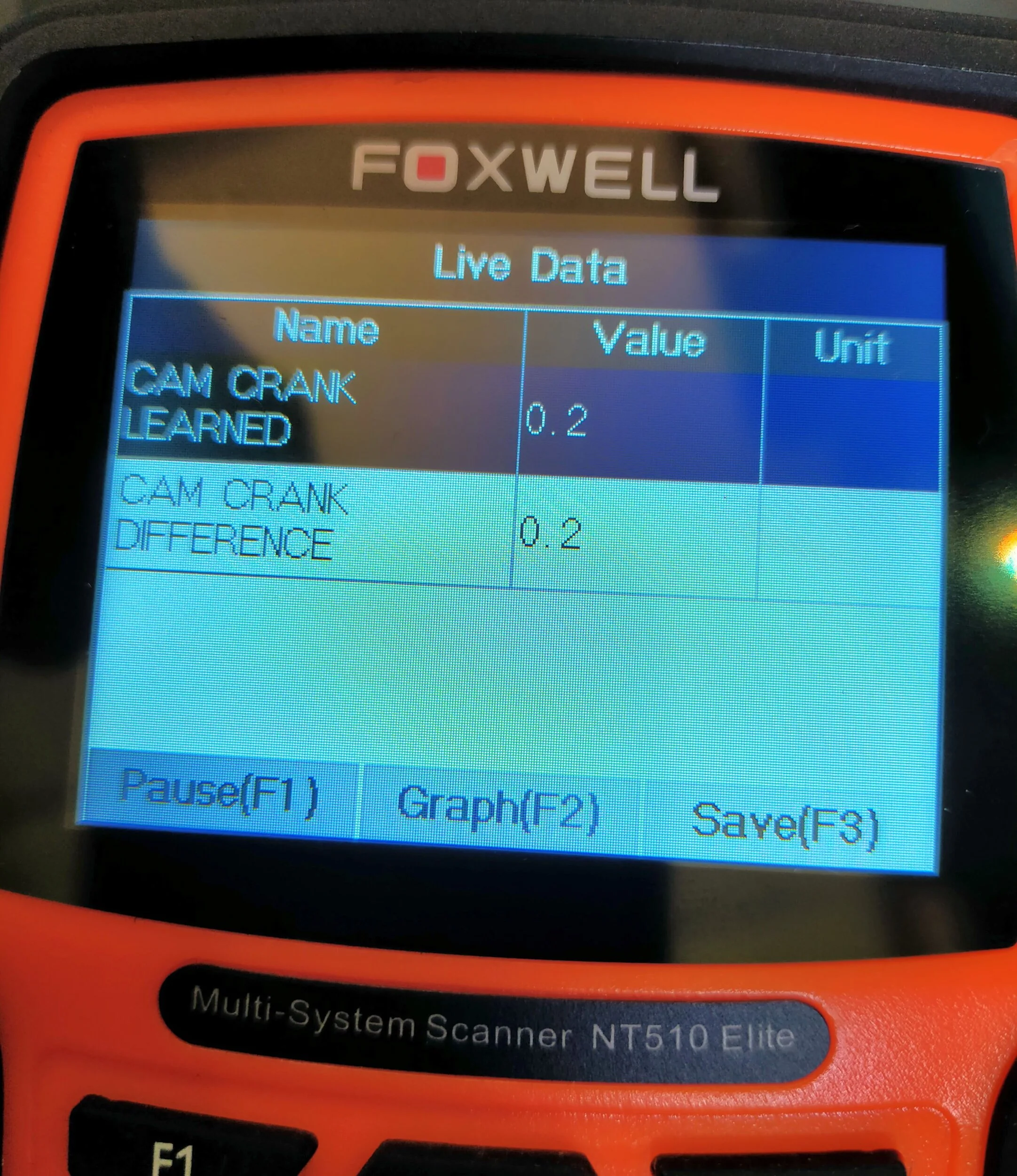

I did the Cam Crank relearn on my 2006 TJ 4.0L with a Foxwell 510 Elite,
but it took several goes and it is a very slow scan tool compared to others that I have used.
I dialed the OPDA in to the lowest value difference that I could get before doing the relearn.
It's probably easier to dial in the OPDA to the existing learned Cam Crank Learned value by using the live data stream feature of the Foxwell 510Elite.
The image below is with the engine running, the learned value is constant and the Cam Crank Difference varies by about 0.1
