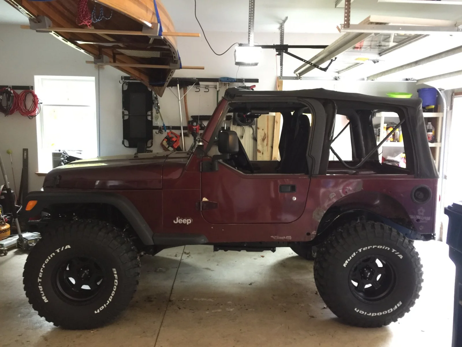

If I do this, what gear ratio would make sense. This project will never be my daily driver. I will use it primarily for off road parks and weekend fun. Any input ?
The most appropriate ratio depends on several things Jim... intended use, ultimate tire size you'll be running, which engine you have, and what transmission you're running. For example, you'd need vastly different ratios depending on if you have an automatic vs. manual transmission.
Reactions: Rocket187um
Nice clean looking TJ Jim! If you have the 5-speed manual, I'd go with nothing other than 4.88 for your 35's. If you have the 6-speed, you could get away with 4.56 but I personally would still go with 4.88. I ran the 35"/5-speed/4.0L /4.88 combination for years and it couldn't have been better for both highway and offroading.
Yep, I would put 4.88 gears in there and get a brand new axle assembly from Currie. You could get anything from a HP Dana 44 to a Dana 60.
