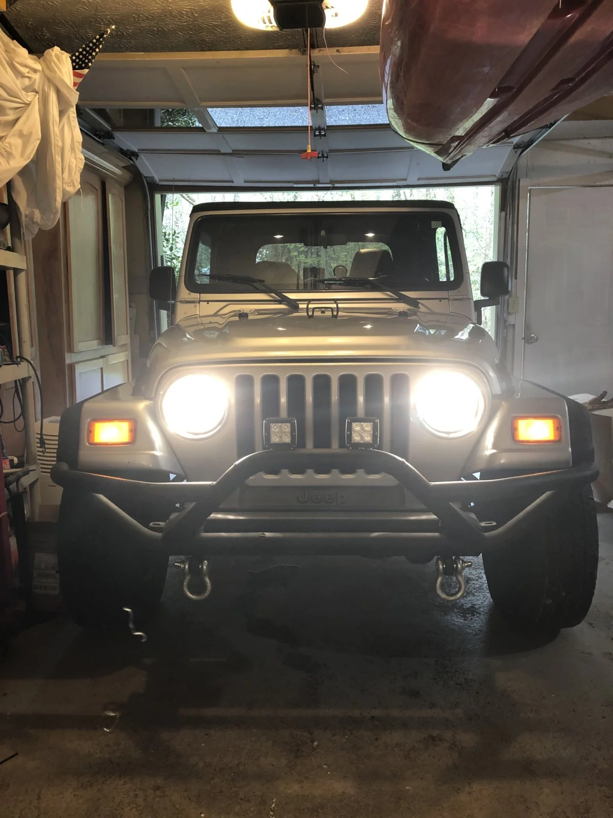

So i just kept looking at and reading and researching LED headlights to replace the poor stock lights i was running. As a stopgap solution i bought some $25 x 2 Sylvaniasealed beams at the local Atlanta about parts store. They were a bit better, but still not great. I started thinking why not get som halogens with new glass lenses and then if i want, i can later replace the halogens with LEDs. I found some great lenses made by Hella and sold by Quadratec. Plug and play with som slight beam adjustment. I bought the lenses that came with 60/55 watt H4 bulbs. Quadratec also sells H4 bulbs in the 100 watt high beam/55 low beam wattage range for about $15. I bought those too. Here are photos of after. I wish I had the before for comparison. I am pretty happy.

U are right about my not wanting to be the jerk driver blinding everyone else. I think you are correct about not putting LEDs into H4 lenses. I also thought the H4 gave pretty good light for not a lot of cash, instead of spending $150 for a LED that got mediocre reviews. I als wanted to fling out there something that worked for me and might help someone else

I have the same hella lens and they are good, it was an improvement. It even came with bulbs which I will run till they burn out and then find a little different bulb.
