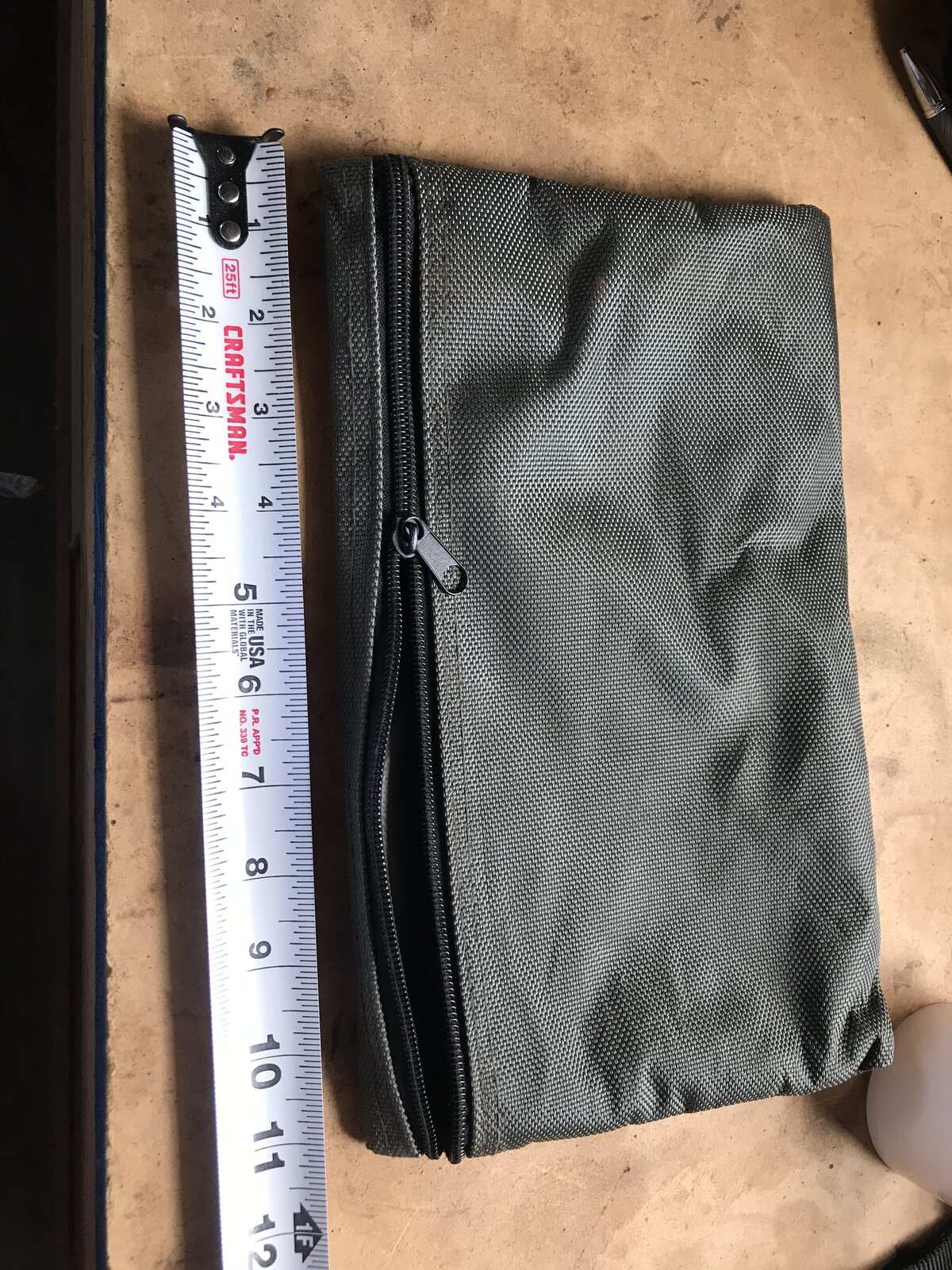

Thoughts on most convenient, flexible, or useful way to carry the kits you have assembled? Personally, I favor an ammo can and a cloth tool bag with a chunk of wood in the bottom to help it keep shape.
the small zippered bags are good for groups of tools, wrenches and pliers in one, sockets and ratchets in another. In the office/school supply area at walmart, theyre pretty sturdy.

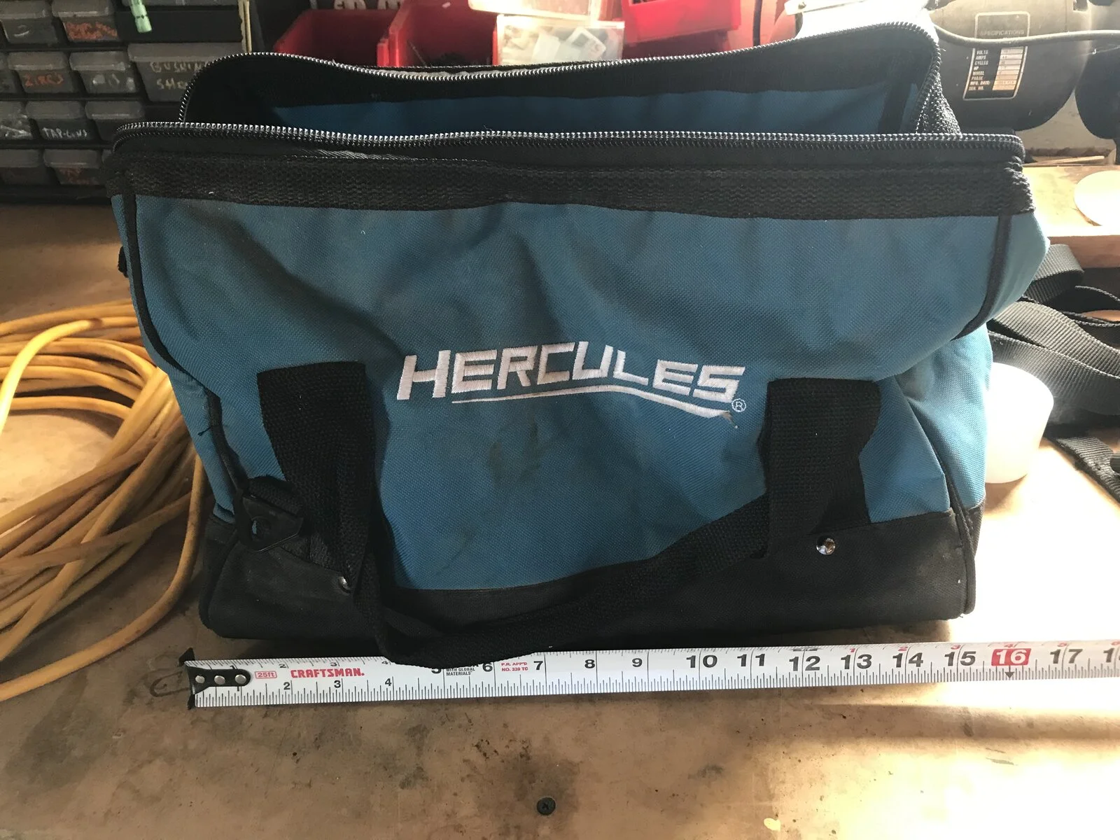

I put all my tools and spares in this bag. $15(?) at harbor freight. The bottom is stiff
