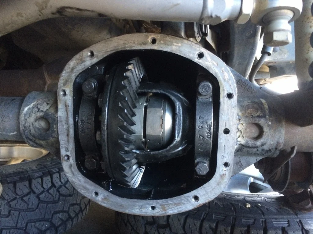

I installed Spartan lockers front and back in September. I love them and I did it myself in a weekend and it only cost me $500 total for both.
I wouldn't recommend them for a daily driver as sometimes they lock up and bang and scares the shit out of me! I've gotten used to it and I know how to drive it better now, but I also don't drive in snow and I could see them locking up and ending up in a ditch somewhere.
Also you can't unlock the front so once you have put your jeep into 4WD really tight turns become impossible and I end up taking it out of 4WD or making 10 point turns.
Anyone who wants quick cheap traction, they are awesome! If I could go back I would save up and get selectable lockers.
