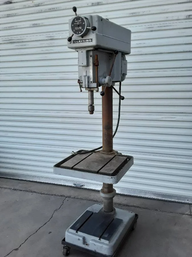

I'd look for an older Clausing.
Reactions: matkal
Thank you for the brand recommendations. Any insight on power, like would 3/4 hp be enough for what I’ve planned?

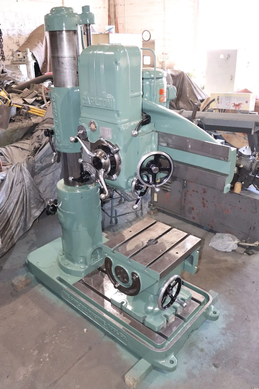

Definitely relevant plus depending on part size (if you don’t go with a mag drill) a small radial may be a great fit.
