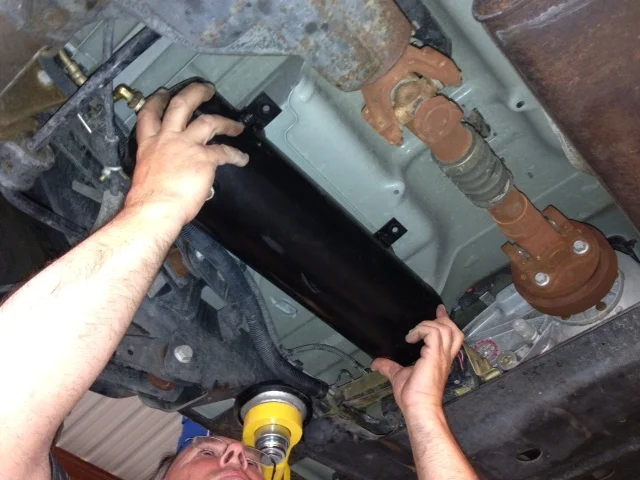

This puppy was an animal but pricey. Had it on my CJ:

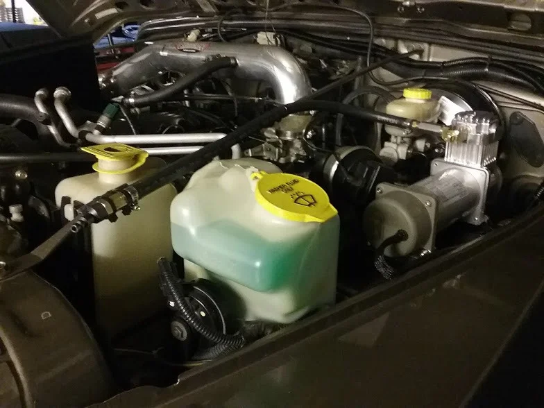

As mentioned earlier in this thread, I have a Viair 400H hard mounted in my LJ , which replaced a Viair 400P that I moved from vehicle to vehicle as needed.
See:
https://wranglertjforum.com/threads/how-to-simple-onboard-air-for-your-tj-viair-400h.10235/

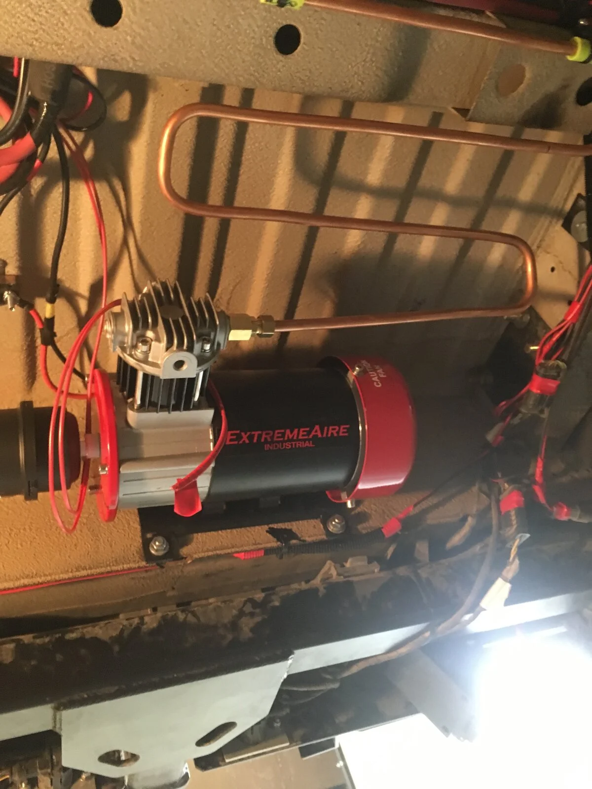

The previous owner of my recently acquired Sprinter Class B motorhome installed an ExtremeAire. It is very fast for a 12v 100% duty cycle compressor. [4.0 CFM @ 0 psi; 2.3 CFM @ 50 psi; 1.6 CFM @ 100 psi compared to 2.3 CFM @ 0 psi, 1.64 CFM @ 50 psi and 1.19 CFM @ 100 psi for the Viair 400 series]
Reactions: WSS

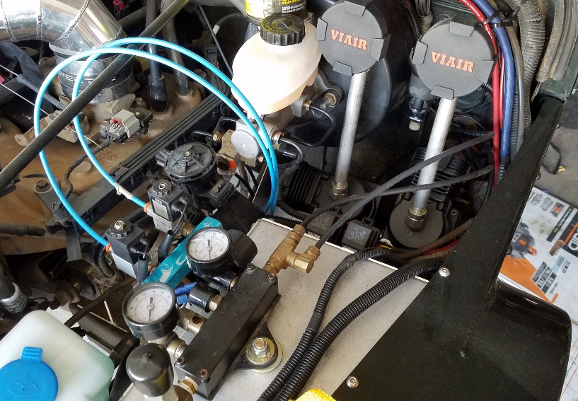

I ran a Viair 380c on the shelf under the brake vac canister for a few years worked fine. I upped the ante a bit and installed a pair Viair 485c's w/ an aluminum 3 Gal Tank. I can air up my 35's in 4 minutes from 12 to 25 psi. I could not get myself to breakdown and get the dual ARB compressor for what they wanted.
Sounds like a nice set up. Curious where you fit the tank? Can you send pics of your installation?

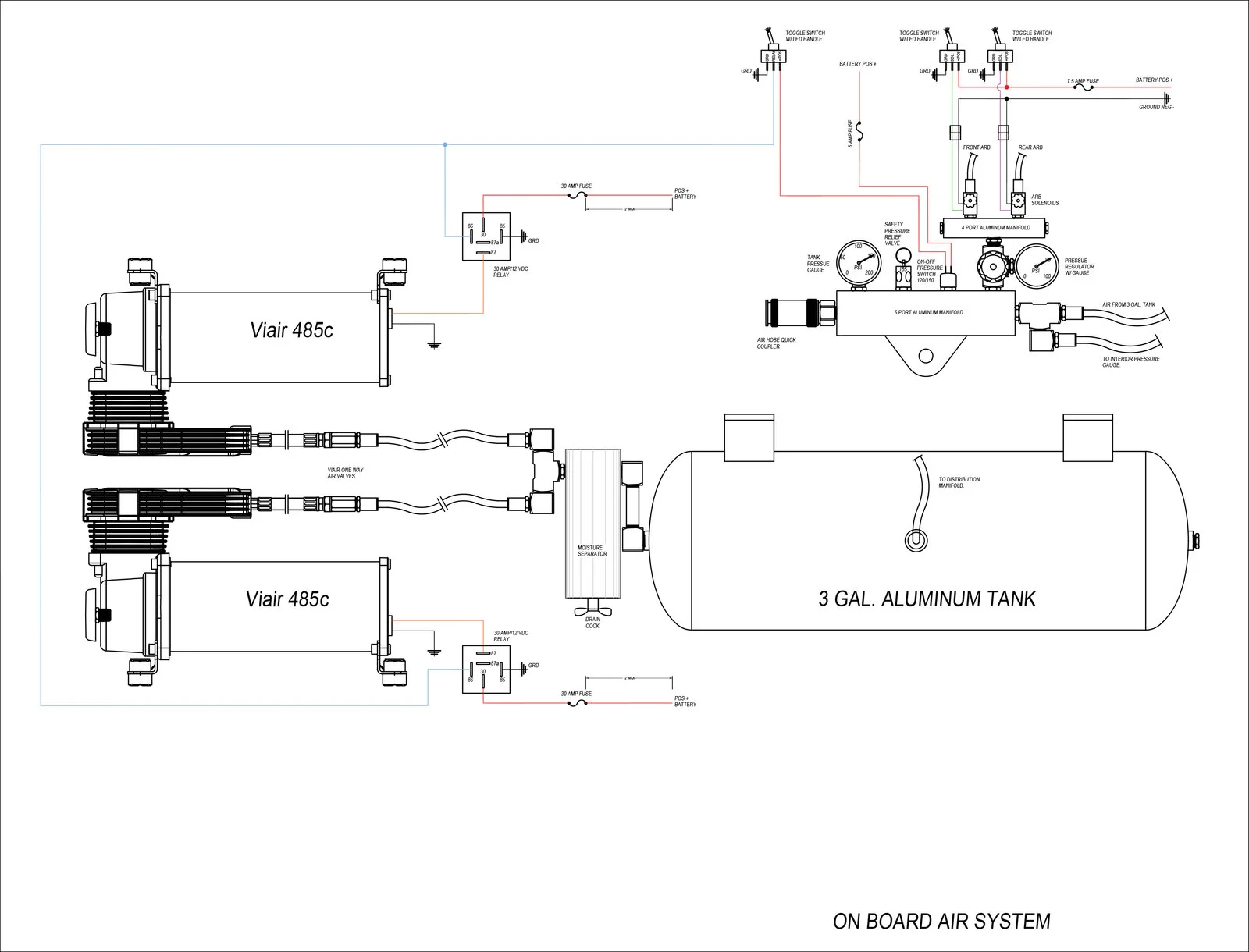

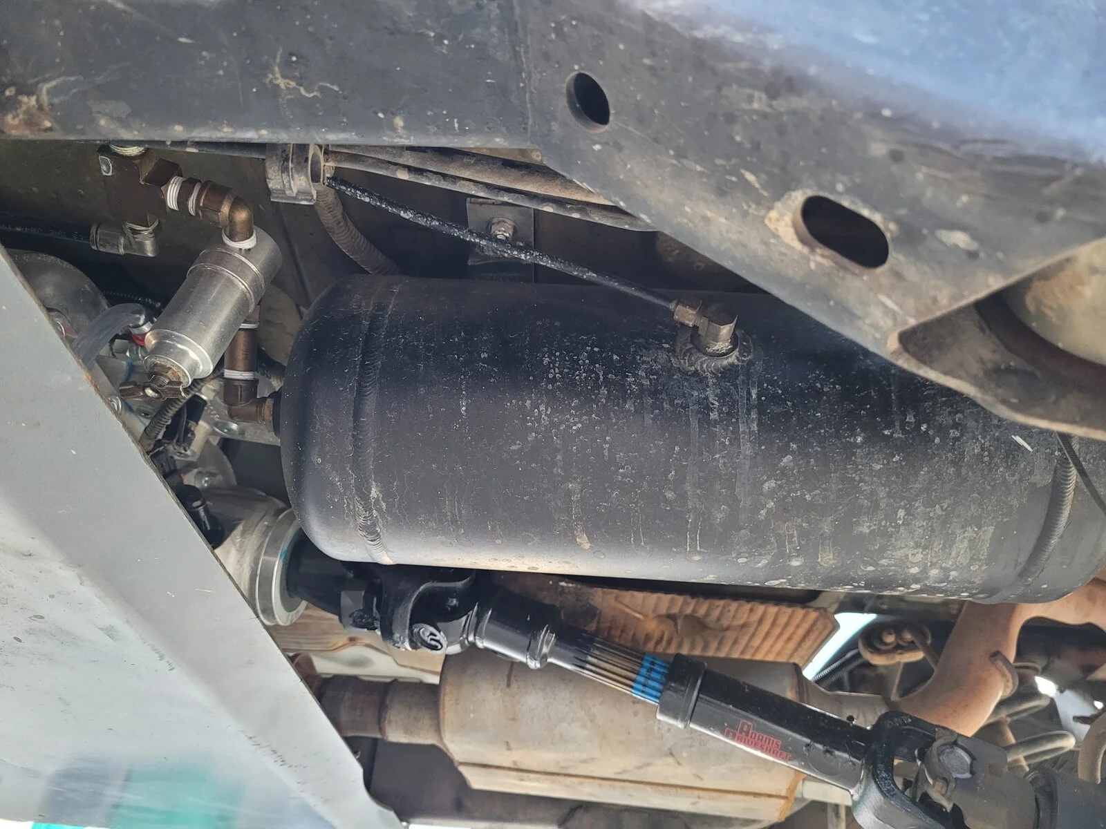

Mine is basically in the same place as the others have shown. A little 3 gal aluminum tank from AVS in Fresno. It's never been hit either.
I've attached a diagram of my system also.
