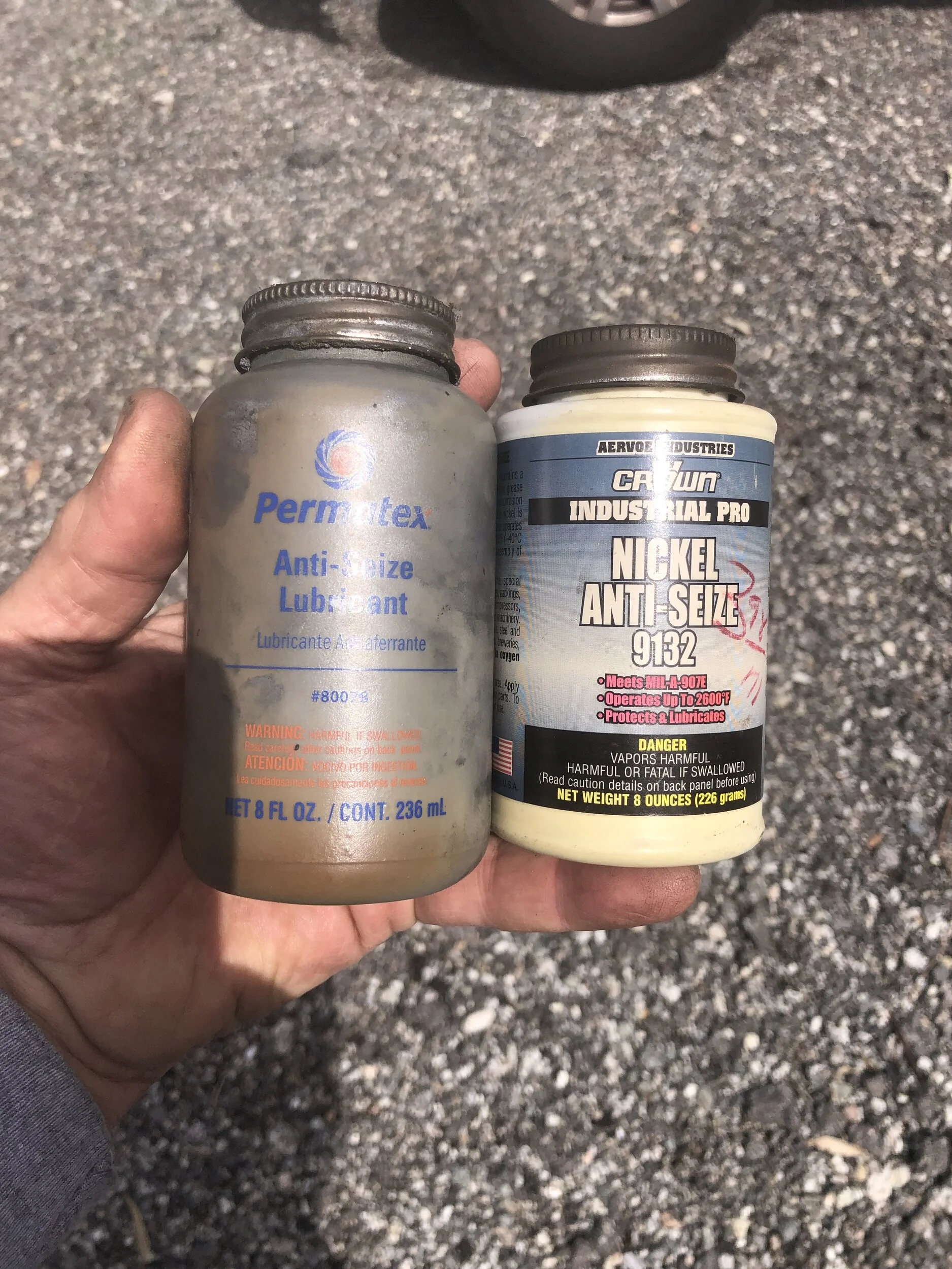

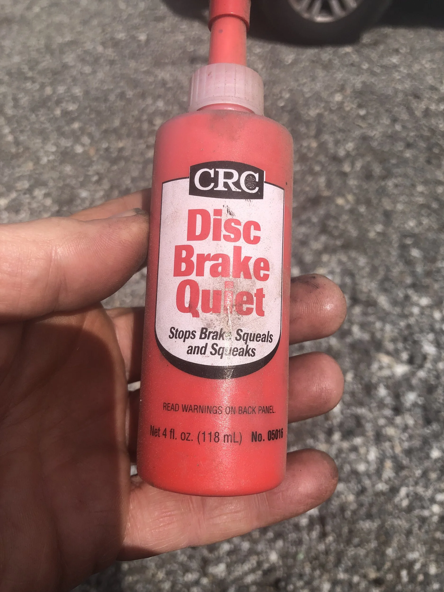

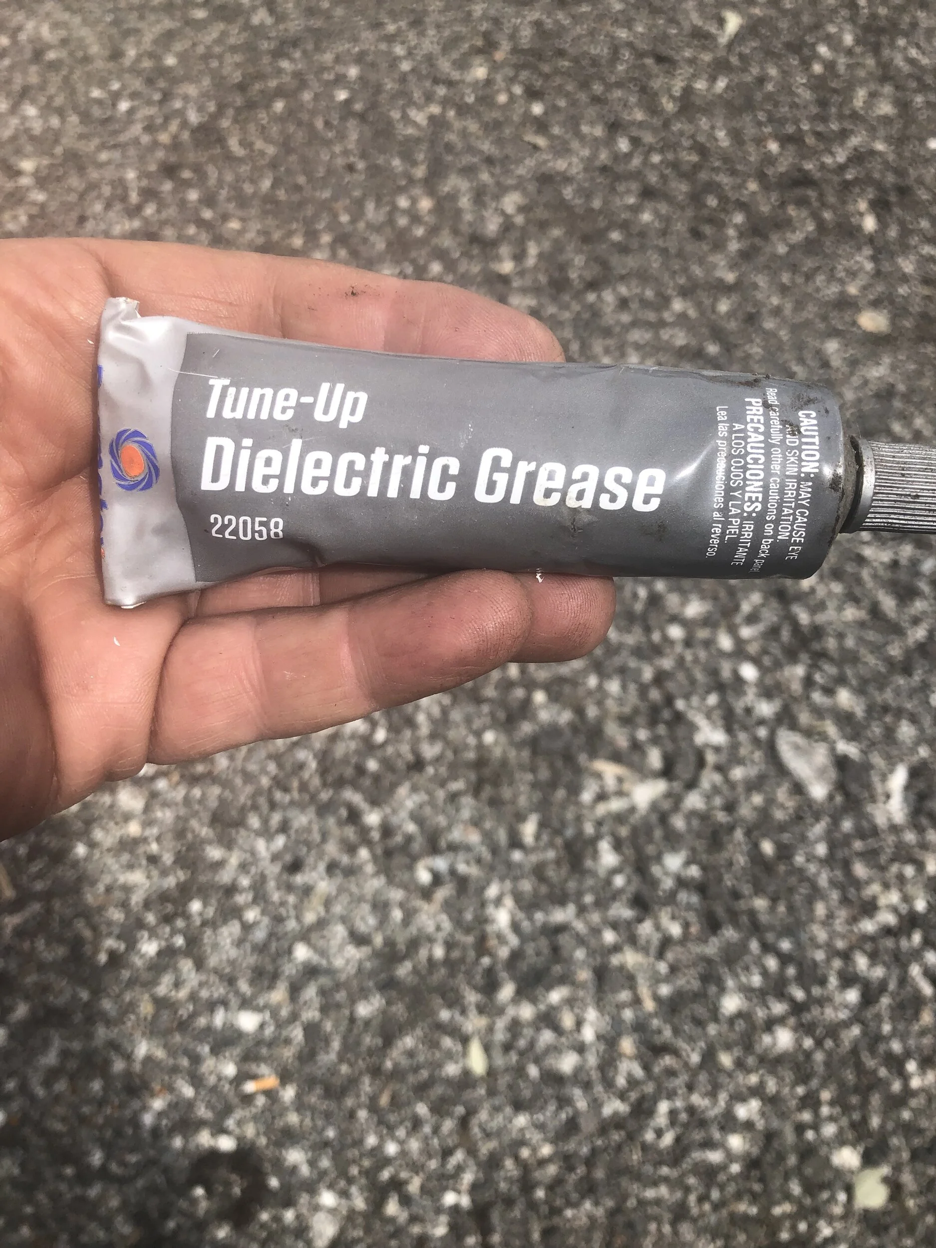

That’s a good employee. Upsell the customer a high markup item. You want an apple pie with that? I just buy a full size tubes/bottles of dielectric, brake quiet and anti seize. Penneys per serving compare to single serving packs and resealable.
I would maybe use dielectric on bulbs if I lived in salt country and I had corrosion issues.
You could just buy a tube of dielectric grease that would last a lifetime and a container of caliper pin slide lube, and there are many products that work on battery terminals.

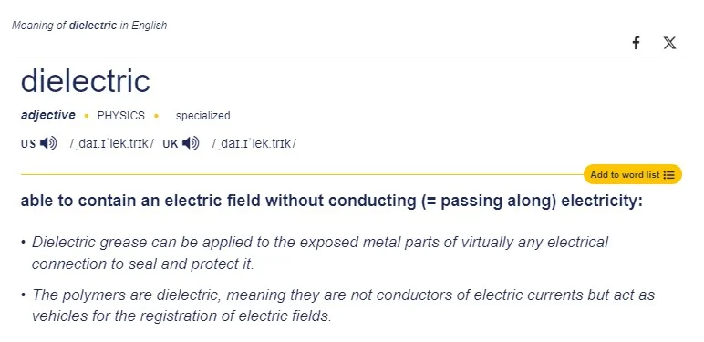

Dielectric grease is not conductive as he says it is multiple times in the video, in fact the meaning of the word "dielectric" is "non-conductive". It can contain an electric field without conducting, in other words it's an insulator.
I can't stand to watch that guy but I'm glad you posted because this video confirms what I suspected, he doesn't know what he's talking about so I'm not missing out on anything by avoiding his videos.
