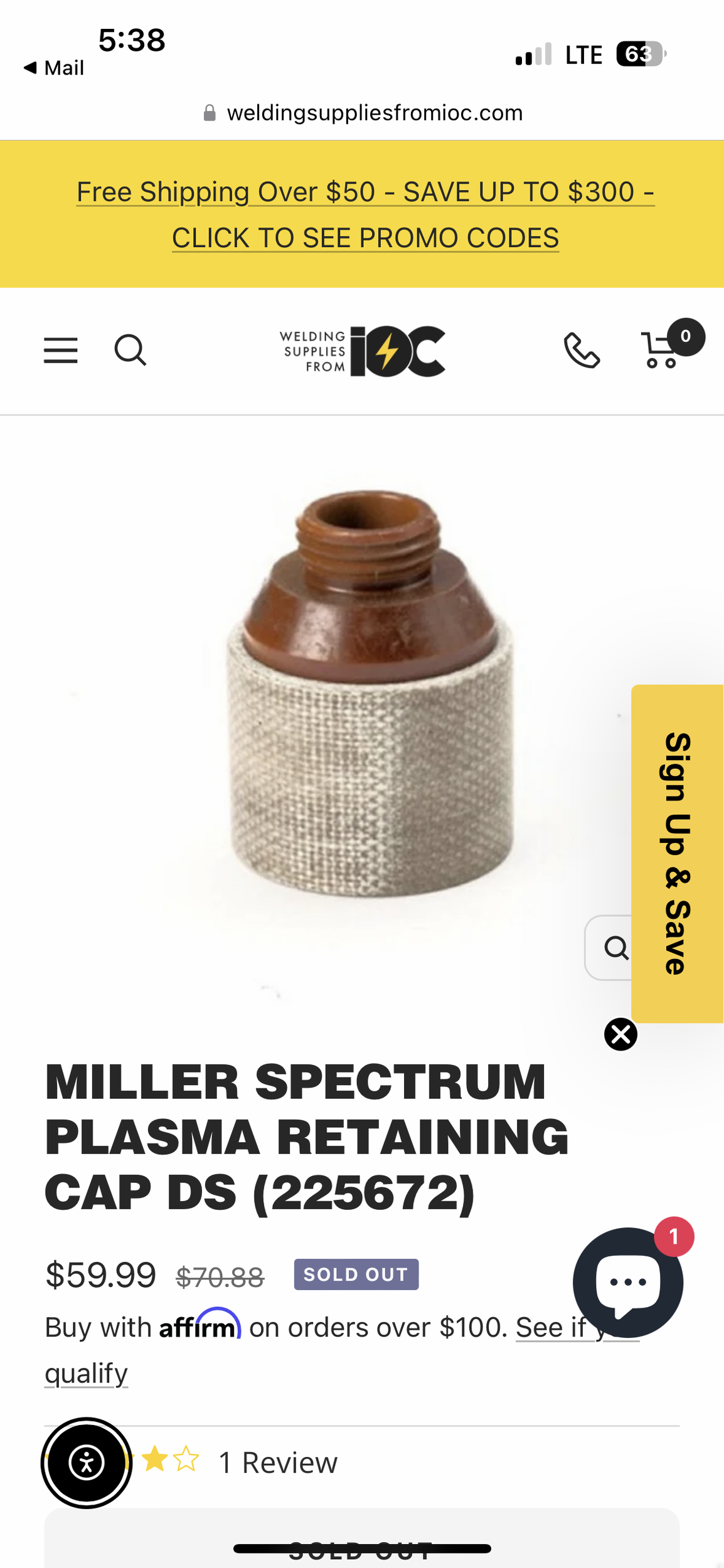

Miller 225672
That's disappointing. I followed that thread and was impressed that you took on that task for a stranger in another country. It's too bad that customer service no longer exists and is making good deeds too much work. I like good deeds - they restore my faith in mankind!
Mr. Blaine, is this a known substitute for the original part, or speculation?
It does but that one, according to part number, is for a 12c torch being 12 amps. Mine is the 27T. Beside amperage I’m not sure if it would fit dimensionally?

Did you see the part about it being discontinued?
