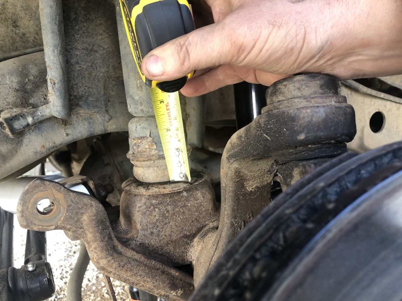

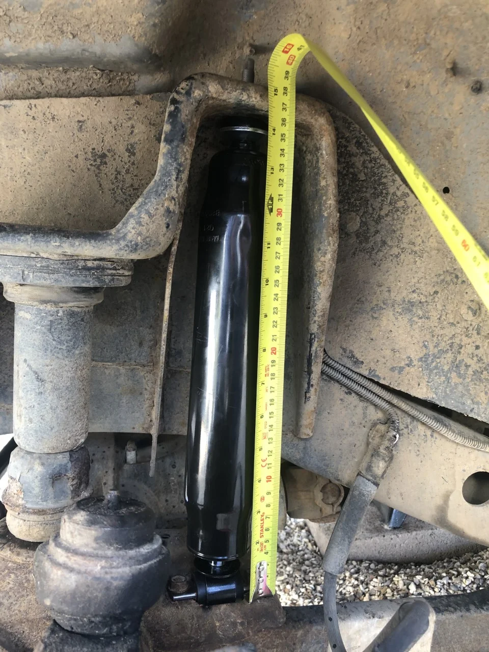

OK, with boots removed it is much clearer. Though I appear to have less bump stop extension required than I thought I would. With my shock almost fully compressed to the minimum 13.5"...
It looks like I need a bump stop extension of just about an inch...
(I know ideally I would remove the jounce bumper, but it is the original one I think and I am concerned it is more likely to disintergrate than come out cleanly.)
In that position I have moved the steering fully both ways and I get no rubbing anywhere. I do not know the fully compressed length of the OME 933(HD) spring, but looking at other springs around the 19.5" mark the 9 inches of space available looks plenty, so that will not be a limiting factor. I do not have my new tyres yet, but measuring from the centre of the wheel hub up into the wheel arch it looks like I have more than enough room for 285/75/16s.
I was expecting more like 2" of bump stop extension, so surprised at 1". From the description and pictures above, can anyone see anything I am obviously getting wrong in working out the extension needed?

It looks like you're doing everything right. You'll still want to put a tire on and turn the wheel from full lock to full lock to check clearance to the top and back of the wheel well.
If the tires clear then 1/2"-3/4" bumpstop would be all you need. If those jounces are on the verge of disintegrating I would remove and replace them. They may disintegrate on the removal but it shouldn't be hard to get the rest out. You'd just pry what remains out of the cup. Cup could use clean up and paint too. LOL

Brilliant, thanks for the confirmation. Think I will put in an inch to be safe, not sure I want to try and shave the hockey puck down. Once I get the new wheels tires on I will check for rubbing and if necessary can adjust at that point. I have noew jounce bumpers on the list of parts for the next time I make an order, but with shipping costs so crazy I try to wait until I have a few things I need.
