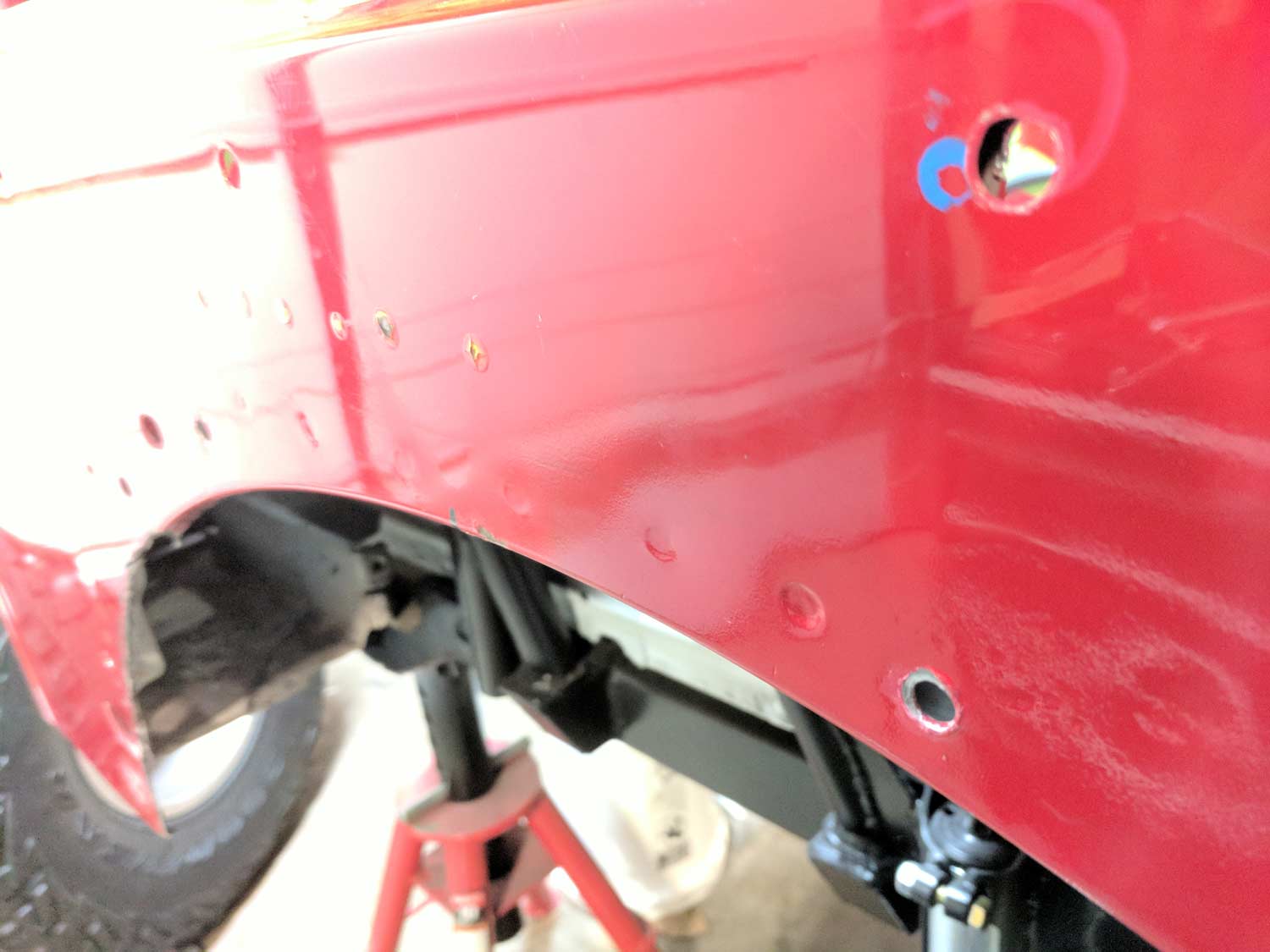

I tested full articulation some more and found the with the 37" monsters (yes, they're starting to look bigger than they did before) and 14" travel suspension I am sending the tire through the spot welds on the fender.

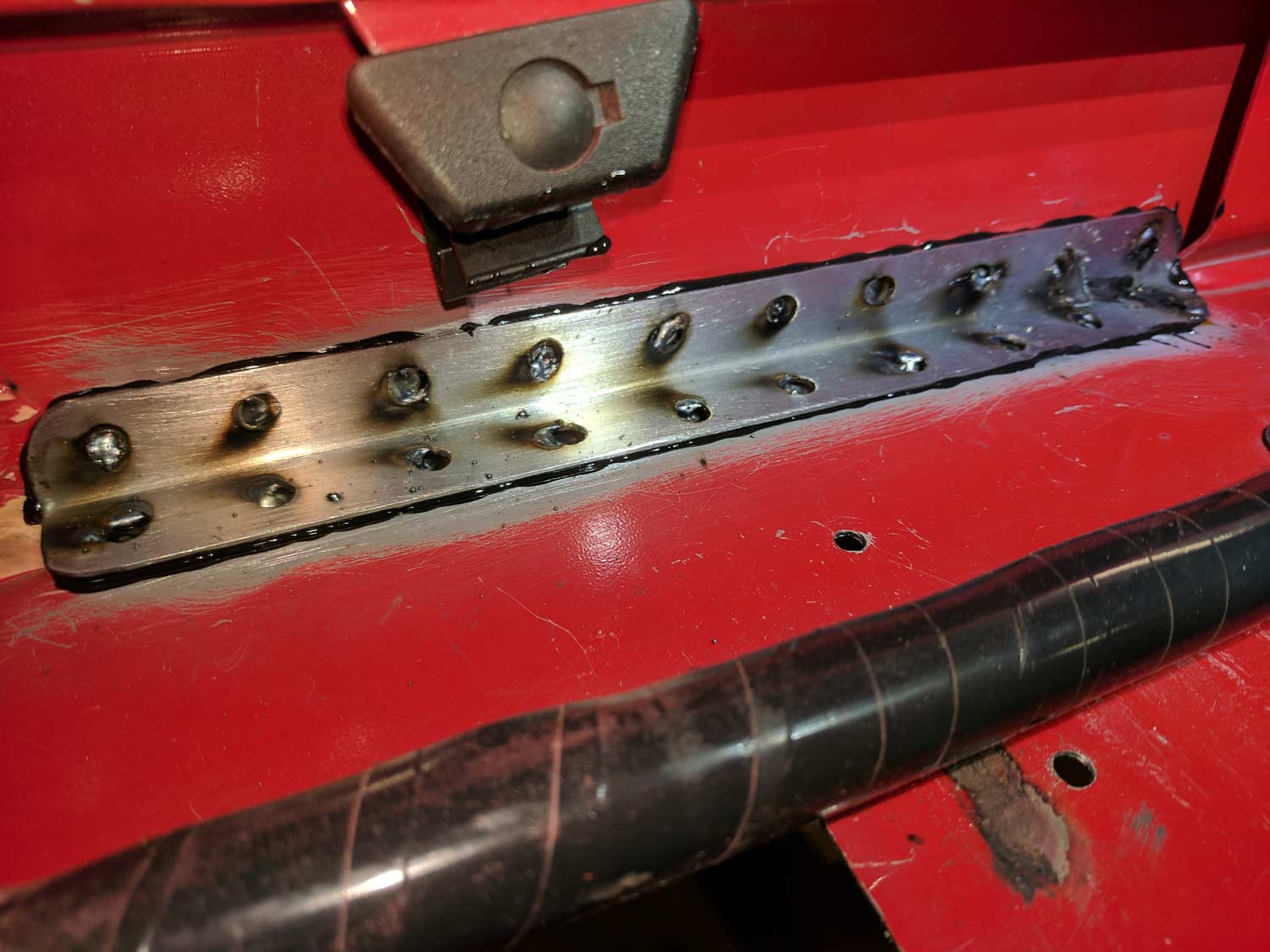

Cutting out the spot welds will cause the inner-fender to separate from the outer fender. To prevent that I flipped the inner-fender flange from down to up.

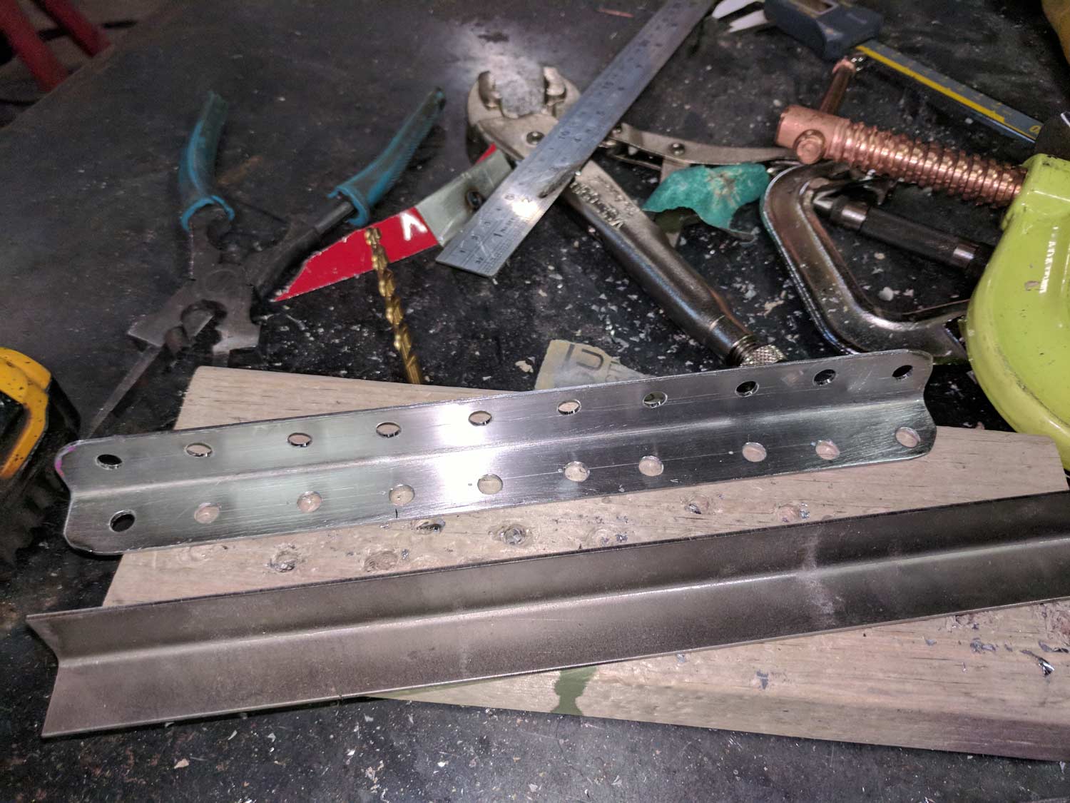

So I ordered angled 16ga sheet steel (I ordered extra if anybody else wants to repeat this I can send you a few pieces), cut them down to 10", drilled a bunch of holes in them, put seam sealer on the back being careful to avoid the spot weld holes. I probably went overkill on the spot welds but I wanted to make sure this area didn't fail after all of the other cutting I've done.

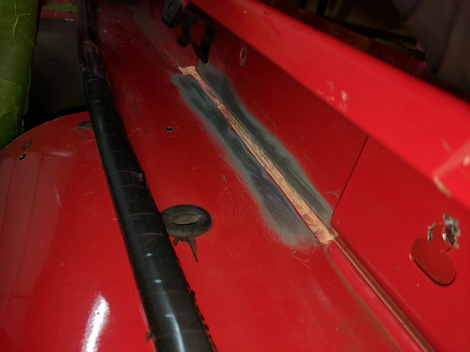

Paint sanded away:
New flange cut to length and drilled:
Spot welded in:
(carpet will be covering this later on)

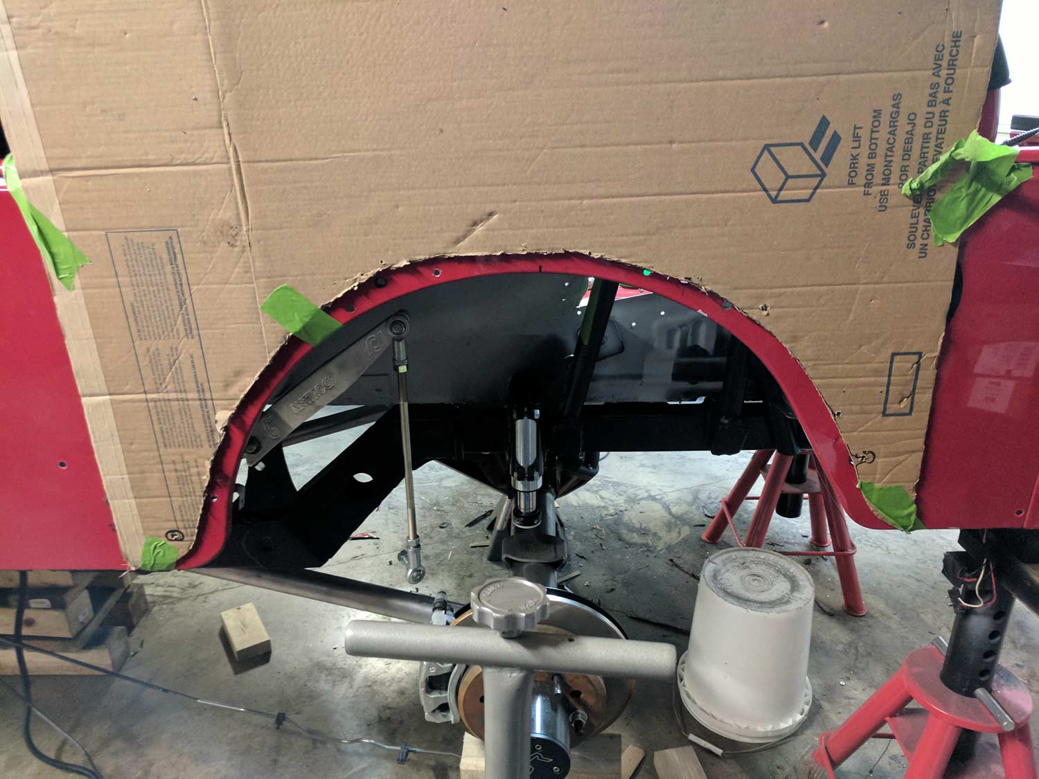

I then mounted a tire and would lift, mark what needed to be cut out, lower, cut, and repeat until I had clearance all the way around the tire. This picture is part way through that process:
Once I was happy with my wheel arch I traced it to a sheet of cardboard and copied it to the other side:
