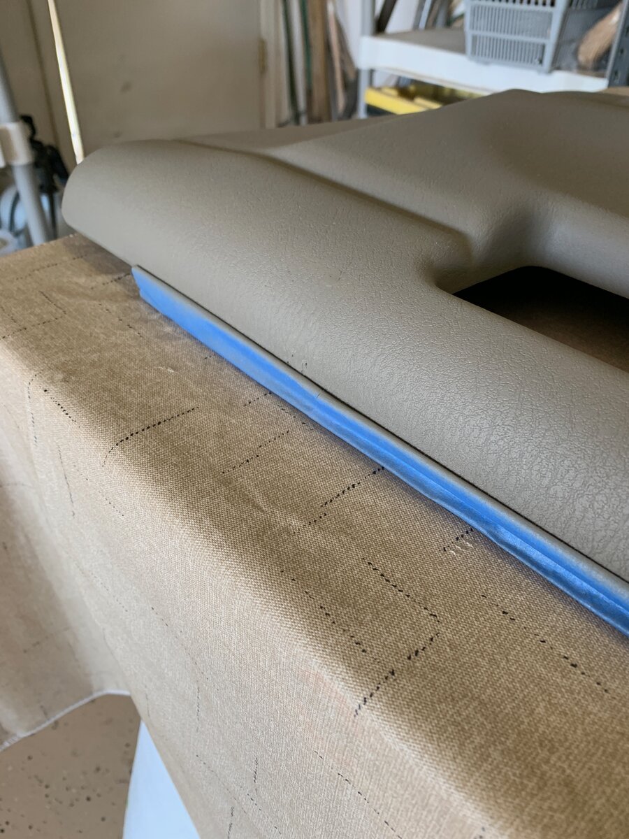

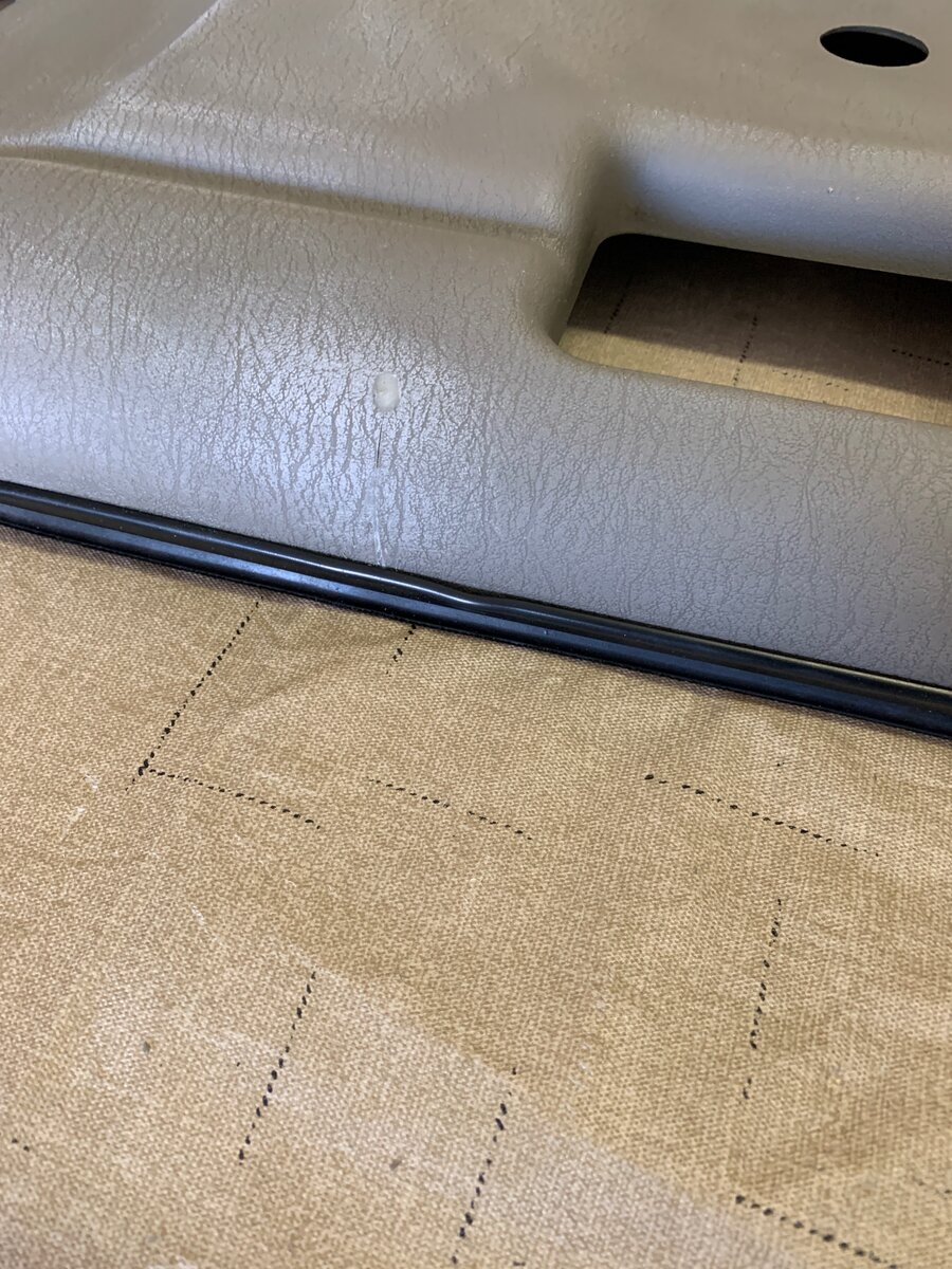

The color difference is noticeable when you set the parts side by side on the driveway. Not at all in the jeep when installed.
For the plug I thought about the epoxy putty which is made for filling gaps but I wanted a thinner material so it would fill in the bevel area. I was worried about trying to "push" the putty in from behind against the tape and getting a raised plug fix. The putty cures to 650psi strength.... the epoxy I used cures to over 3700psi.
Af for texturing. I removed the tape from the epoxy at 15 minutes (setting time) and used a very small flat bladed screwdriver to fake in a little texture. If you focus on it you can see it but otherwise it worked great.

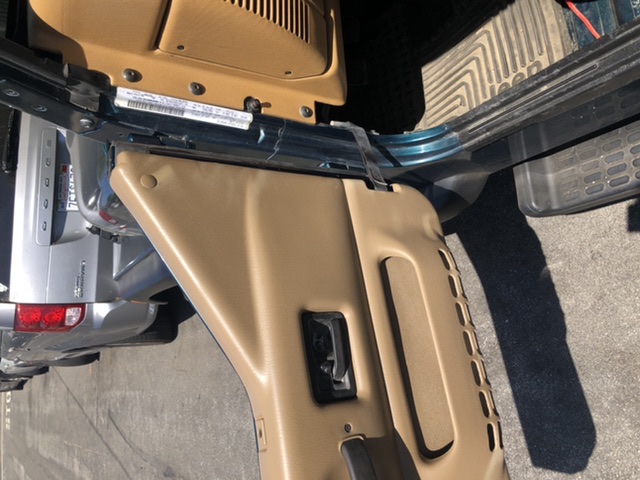

When I do my door I may reverse cast a strip of my broken defroster vent trim about 1/2" wide and then tape it over the cracked portion of the door panel to get the texture in the epoxy fix.

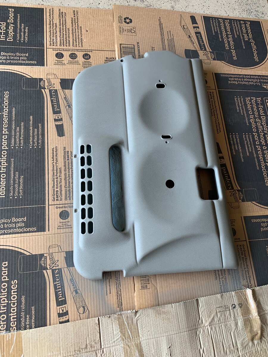

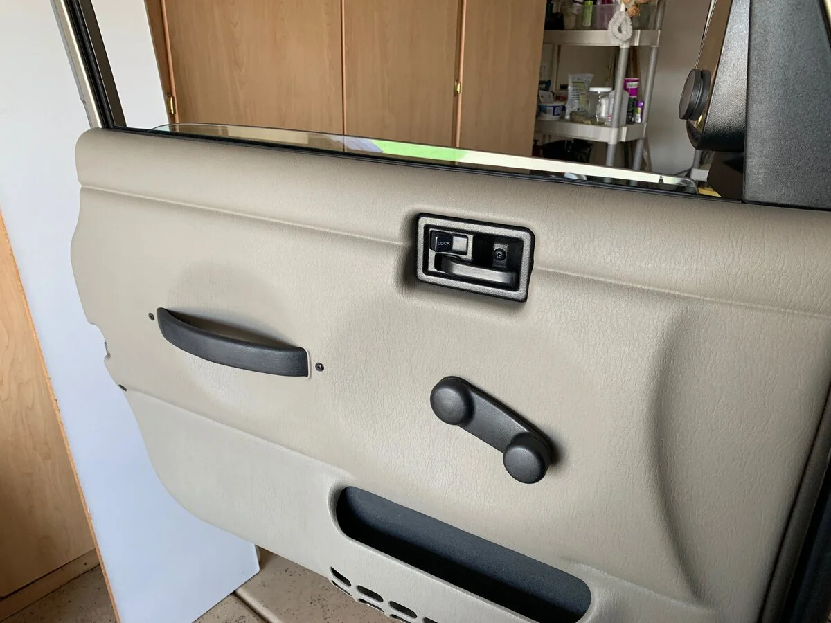

I just painted some interior panels on my half doors based on the info in this thread and thought I’d update it with my experience. I have a 97 with a paint trim code of K5T6. Based off T6, I chose 15033 SEM paint called “Saddle Tan.” It wasn’t an exact match but it’s fairly close. It’s a 23 year old ride so I’m not too concerned with it being an exact match. They look way better than they did before so I’m happy with it.

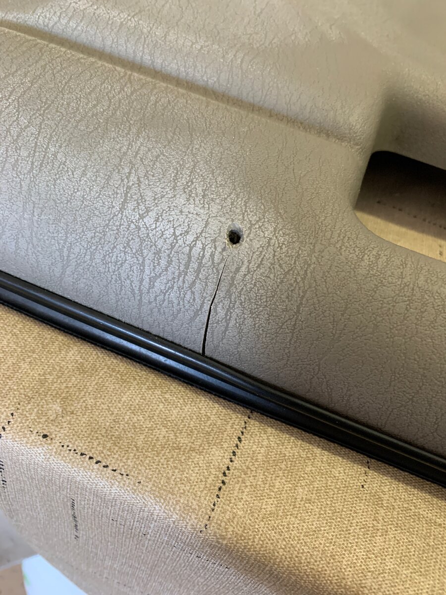

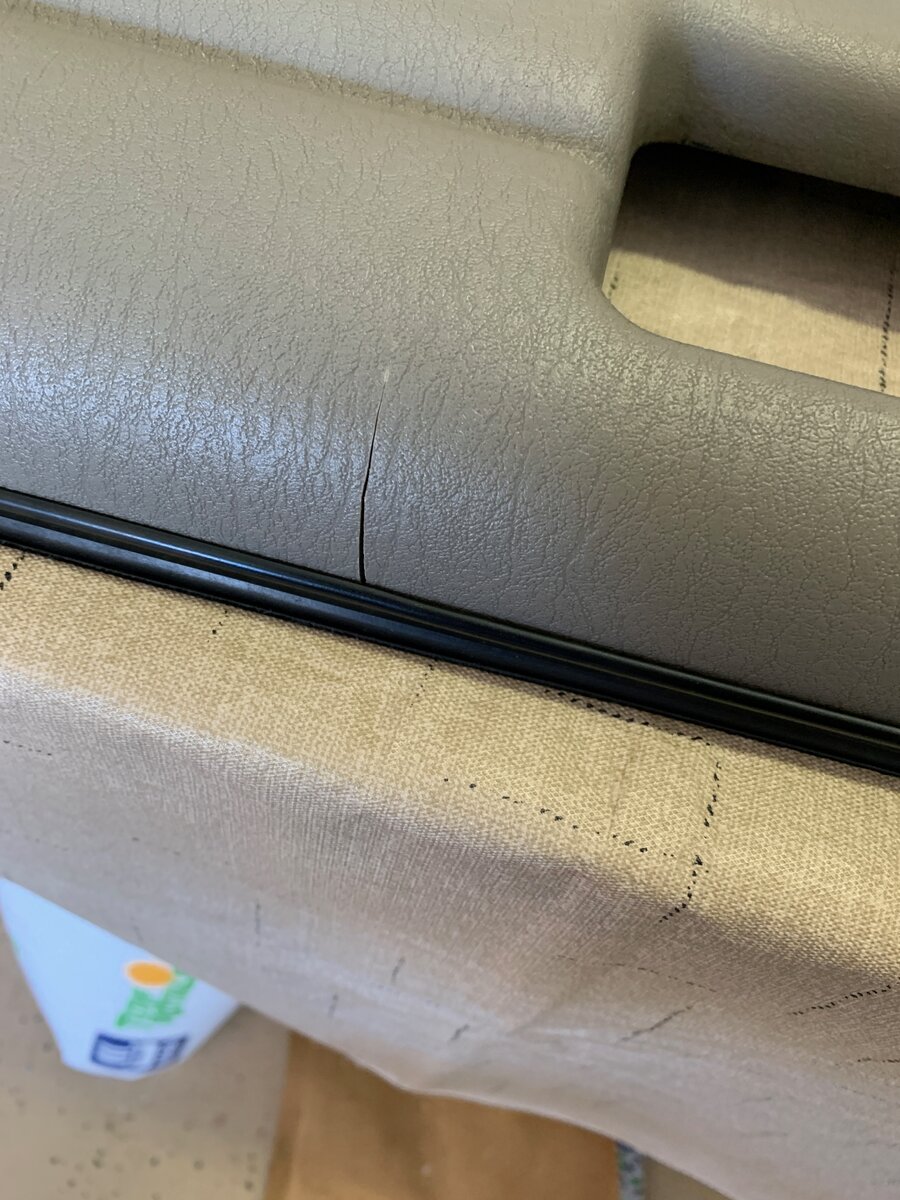

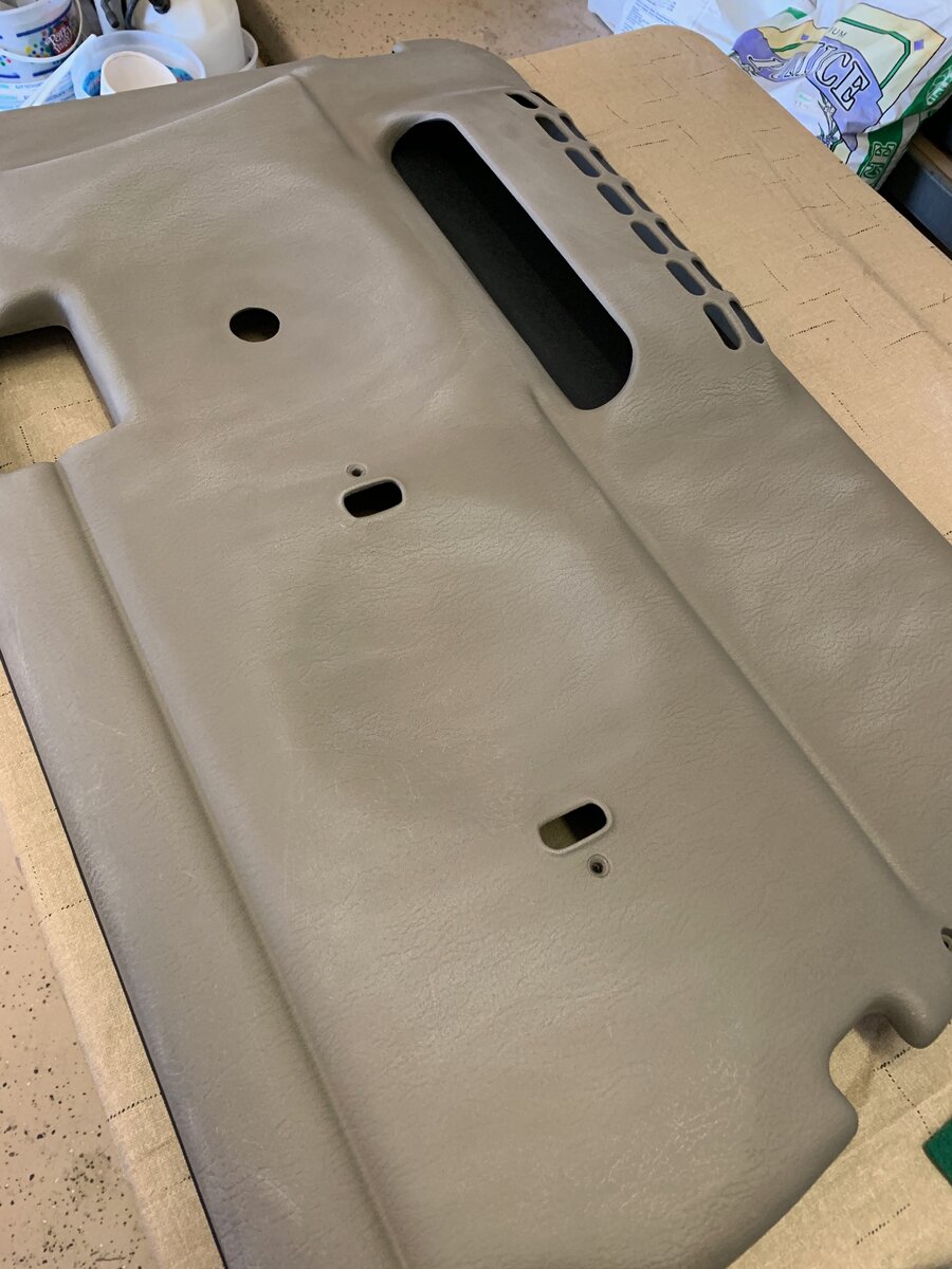

Today I did my driver side door which has the typical crack that seems to happen in a lot of TJ's.
I started by cleaning the door panel with the SEM Plastic&Leather prep (38353). This product is also a mild solvent and will not only clean any surface dirt off the panel it will also take a thin layer off of the plastic itself. This helped eliminate a couple sun faded areas nicely.
I fixed the crack by drilling a small hole at the end of the crack and using an epoxy formulated for plastic to fill the crack/hole.

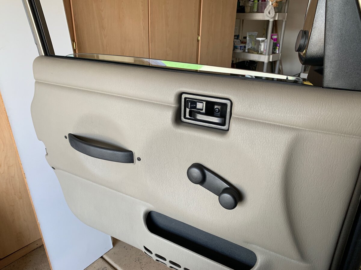

I then applied the adhesion promoter and 3 light coats of SEM Color Coat in Khaki (5545) over the entire panel.
The crack is barely noticeable up close. After the paint cures I will perform a very light buffing using my polisher. I found that this gives the coating a similar luster to the existing dash components when I did the defroster vent trim last week.
EDIT: Buffed the top out with "Shop Towel" (Blue paper towels) and my buffer with a very light touch. and installed.
I'm happy with it and vs the cost and difficulty of finding a Khaki intact panel vs $60 in materials and some time it's a great fix that I think will last.

I did some research on this.... JB Weld makes a few epoxy products for plastic. There is a putty that has a 650psi or so strength and then there is the "Plastic Bonder" which has a 3,700psi strength. Both will stay somewhat "soft" in that they are not more rigid than the plastic. I chose the "Plastic Bonder" over the putty not because of the strength difference, 650psi is most likely stronger than the plastic itself, but because it mixed into a much thinner liquid and would flow into the crack easier from behind.
I put tape on the front side over the crack and then pushed the epoxy in from behind with a flat plastic putty knife to make sure I got in the entire crack. Once I was satisfied that the crack was filled I added a small strip of fiberglass fabric (bought at ACE hardware for $4) and a thin layer of additional epoxy over that.
Once it was fully set at about 30-45 minutes I pulled the tape and lightly went over it with a Green Scotch Bright pad (medium abrasive) to take any raised portions off and clean it up.
I started by cleaning the door panel with the SEM Plastic&Leather prep (38353). This product is also a mild solvent to it will not only clean any surface dirt off the panel it will also take a thin layer off of the plastic itself. This helped eliminate a couple sun faded areas nicely.

When you remove the panel you'll see why this happens. The black cap trim for that presses against the window to keep debris out of the door cavity has non-continuous clips that are stapled into the door panel. The clip stops at the front bumper side of the door at the exact spot of the crack. My theory is that the motion of window up and down torques the clip into the panel and as the panel ages it becomes more brittle and eventually cracks at the transition point of the clip to the panel. At least on mine the end of the clip and the crack were in exactly the same spot.
