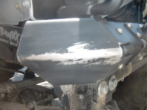

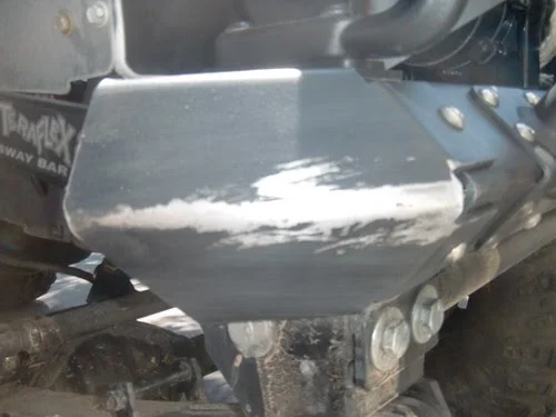

Both of bumpers were painted about a year ago and they are starting to look a little janky. A few more chips and scuffs, plus some pin-head sized post-winter NE rust spots are showing through so I am going to refinish them...again.
I'd always been a proponent of painting versus powder coating, primarily for ease of touch-up, but I may be changing my position on this... had I powder coated them they likely would not need to be refinished a year later. Live and learn.
So, not likely going to paint them again.

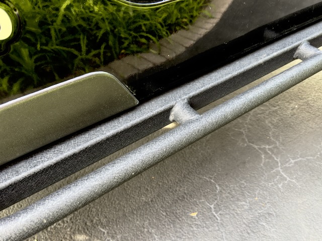

I am looking to match the Body Armor side step / pseudo slider. It's powder coated, with a slight texture and semi gloss..
Several people I know have had great success with Raptor Liner. If I were to need to coat anything with bed liner, it's what I would use. And should look similar to those steps.

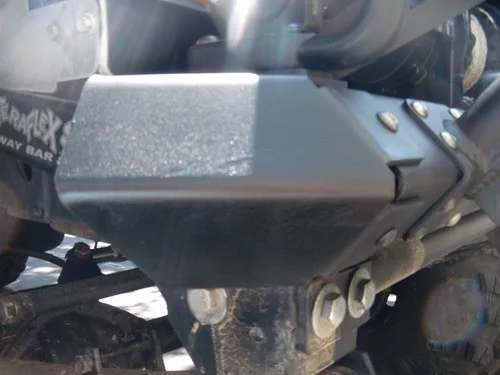

I’ve always used rustoleum textured black on any of my scratched powdercoated parts and unless you know what you are looking for you’d not know.
Textured black bedliner? Or a different textured paint?
