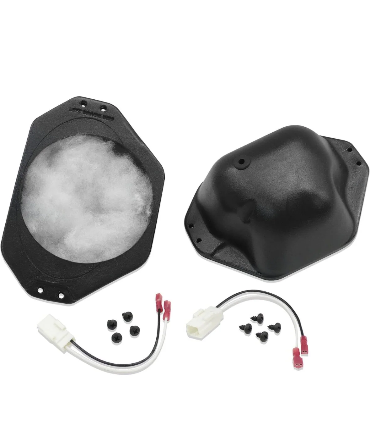

I’m going to install my 5 1/4 Focal speakers soon and wanted to get some feedback on the Select Increments Dash-Pods?
Tell me your experiences?
Thanks.
Begin rant: As someone that was in FRP manufacturing for 20 years. I have a hard time paying $89 for something that shouldn’t retail for no more than about $39 and really can sell profitably for $25. However, if there really is an improvement in sound then the gouging by the manufacturer should be moot, right? :End rant.

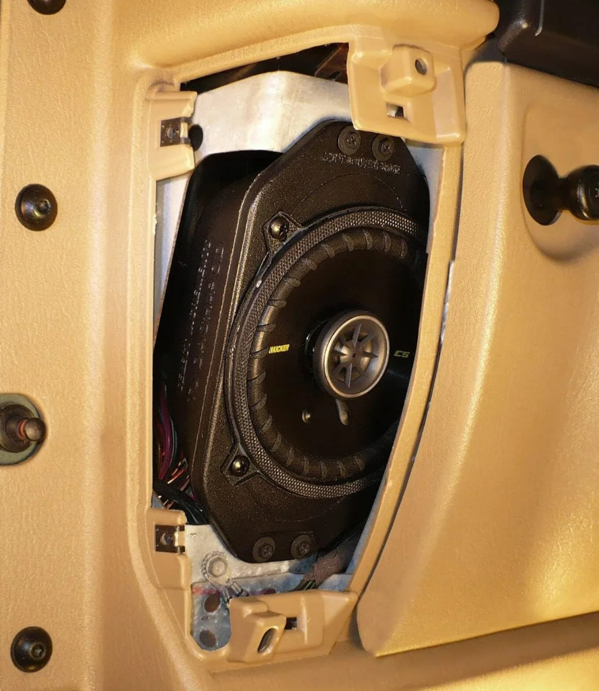

I have them. Vented them as someone advised above. Kicker speakers, a little polyfill, they sound pretty good considering they're aimed at my knees. Better with them than without them. I'd buy them again.

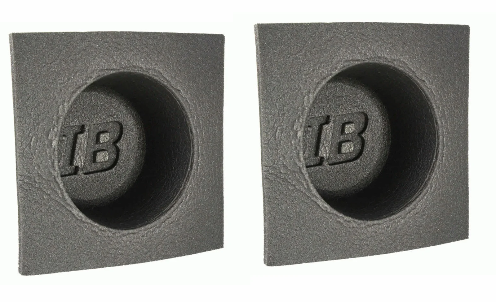

I don't know about that. I just looked at their website, and their scratch and dent pile has a $115 price on them. If you can get them for $85, it sounds like a bargain. Of course, the $10 baffles I used sound a LOT better now.

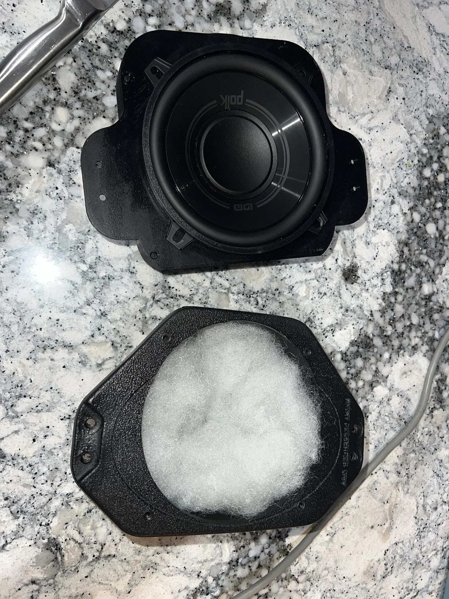

Another member on my gun forum printed me the 3D printer pods (top) I found the files on here for free and he hooked me up. I was about to buy my own printer to do them too
I also personally feel coaxials do not produce good sound to the listener. No POD will fix that.
You need components up front with the tweeter up on the dash. I tried 4 sets of speakers and finally kept the Polk DB5252 that Crutchfield recommended

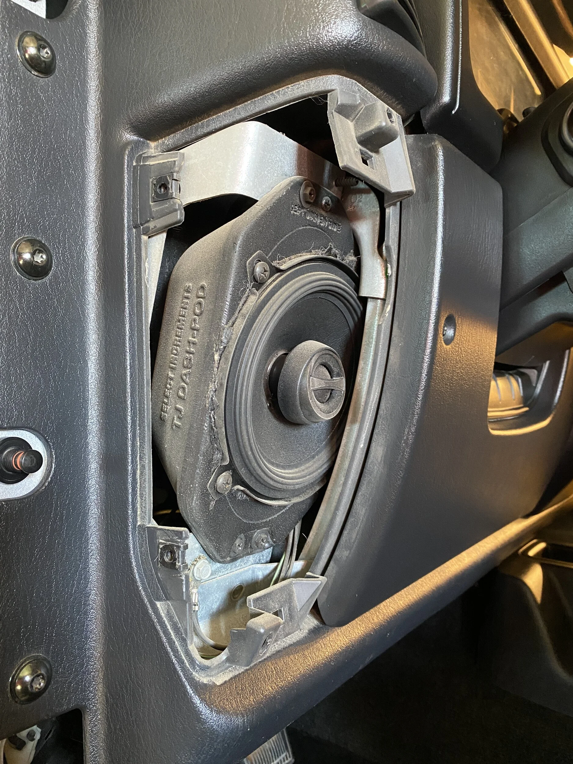

I have them and can tell a huge difference before and after. They project the sound out of the dash instead of into it. IF you have a pre-2003 TJ, you will have to cut a piece of the dash out on the driver side so they will fit.
I installed polyfill in mine as well as my sound bar. I would buy them again in a heart beat.

I agree with this. Before I couldn’t hear the music coming from the dash and after installing these pods, I now can. You shouldn’t have a fear of over powering the rear pods. Just based on placement alone, the rear pods will always be heard over the fronts. I do think these pods are worth it but they only really matter when you’re amplifying and upgrading drivers.
