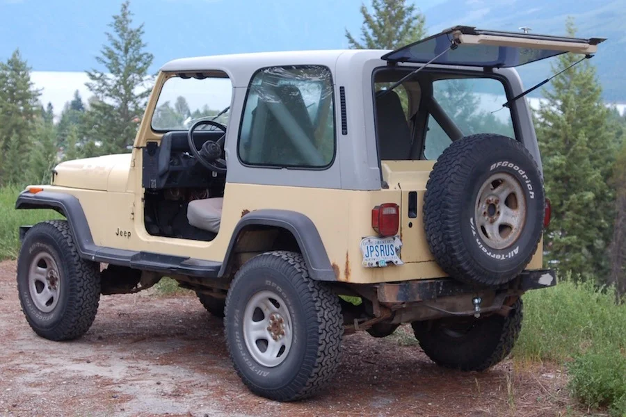

I ran 33x9.50x15s BFG KOs on stock 5 spoke steel rim, 15x7, on my '87 YJ. And I had 255/80x17s on my TJR with the stock Moabs. Not every 33x10.50x15 is 33x10.50x15. Therefore lots options. Sometimes you might need to limit steering stops. The only guarantee is the factory size will fit.

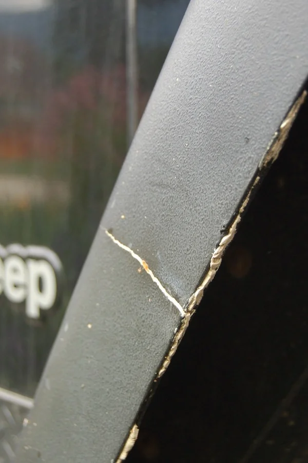

Heres my repair after cracking a flare on the trail... bit of 2part marine epoxy and a piece of plastic bedliner.

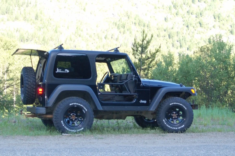

'05 TJR, stock suspension
AEV HighLine with 33s
