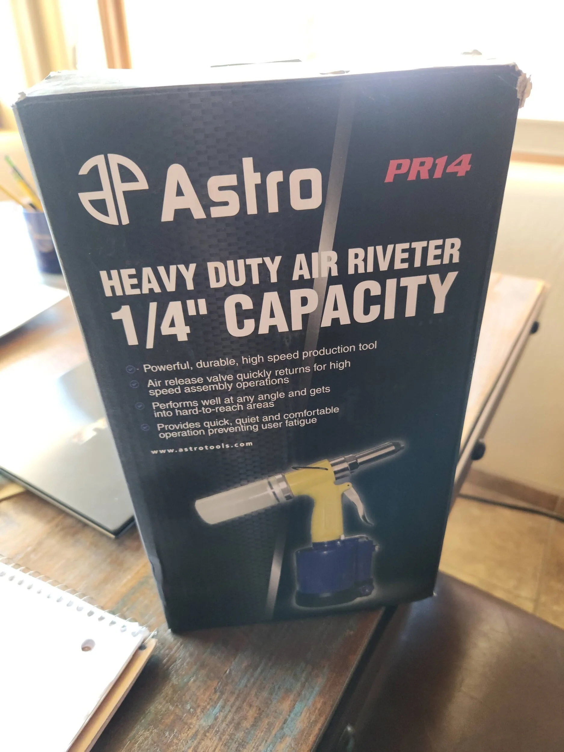

I had a need to install 1/4" stainless pop rivets and ended up with this air powered tool:
Worked great for those tough rivets and since I use it very rarely, being air powered is not an issue. It also uses very little air. If I was using it frequently, I might go for a Milwaukee battery unit but the M12 can't pull 1/4" rivets. For that you need the M18 version which is pretty pricey especially compared to the tool I ended up with.
I have the same one and it works great although not so easy to maneuver in a tight place, but when the M12 rivet tool came out I seriously thought about buying one but I no longer do enough riveting to justify yet another rivet tool.
