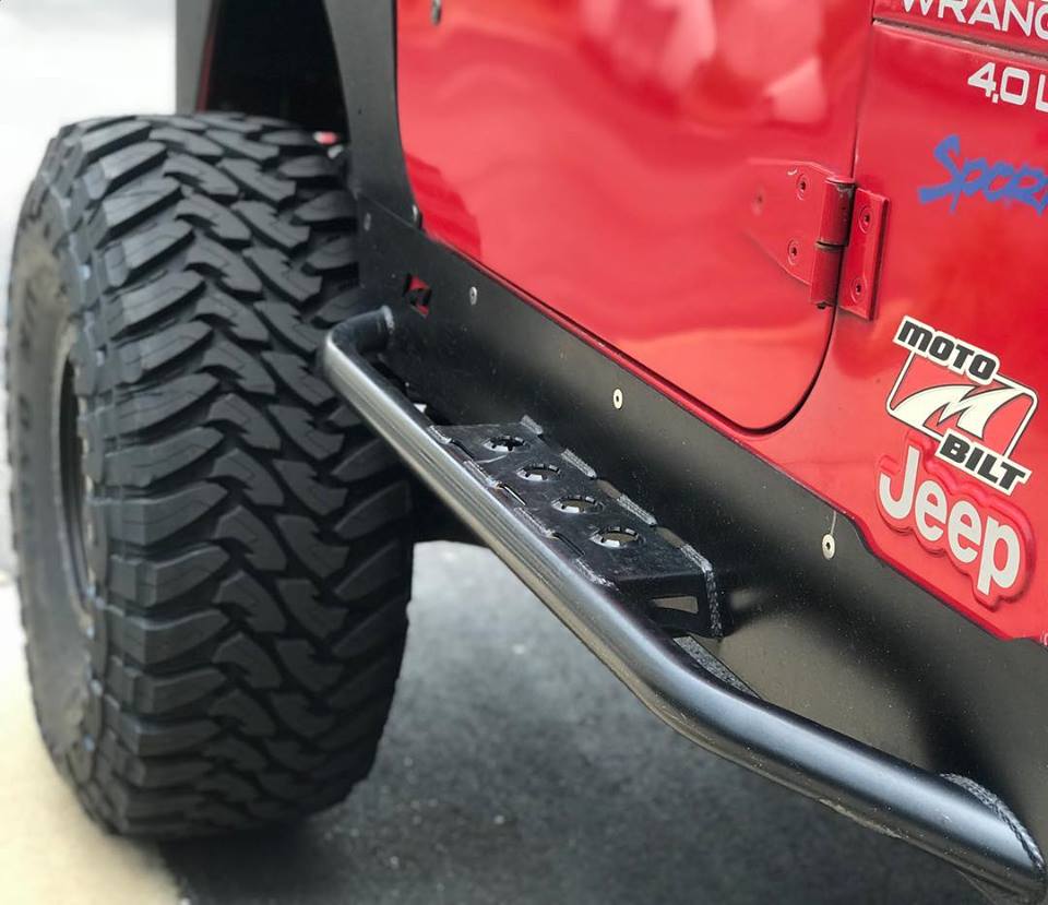

We have a step option at Motobilt. I have them on my TJ.
https://www.motobilt.com/body-armor-bumper/rocker-guards/jeep-tj-rocker-guards.html

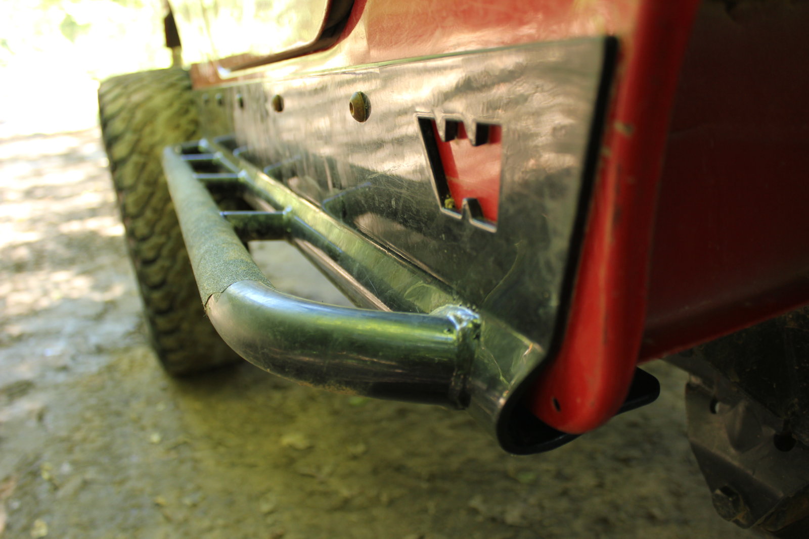

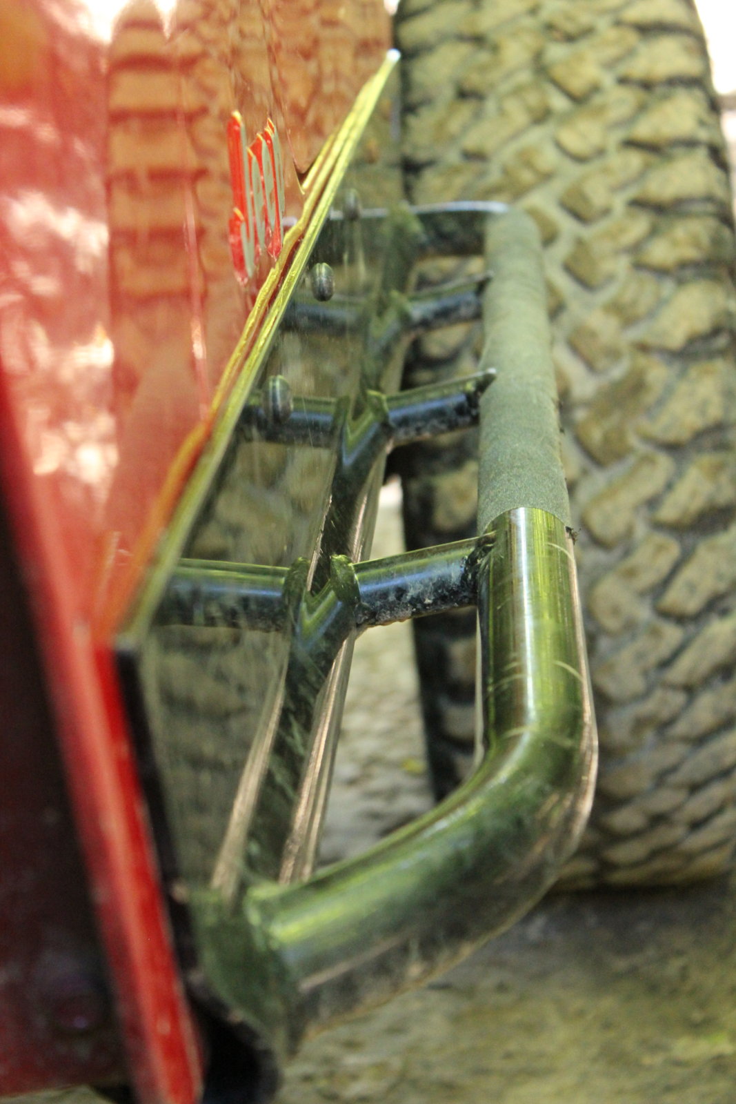

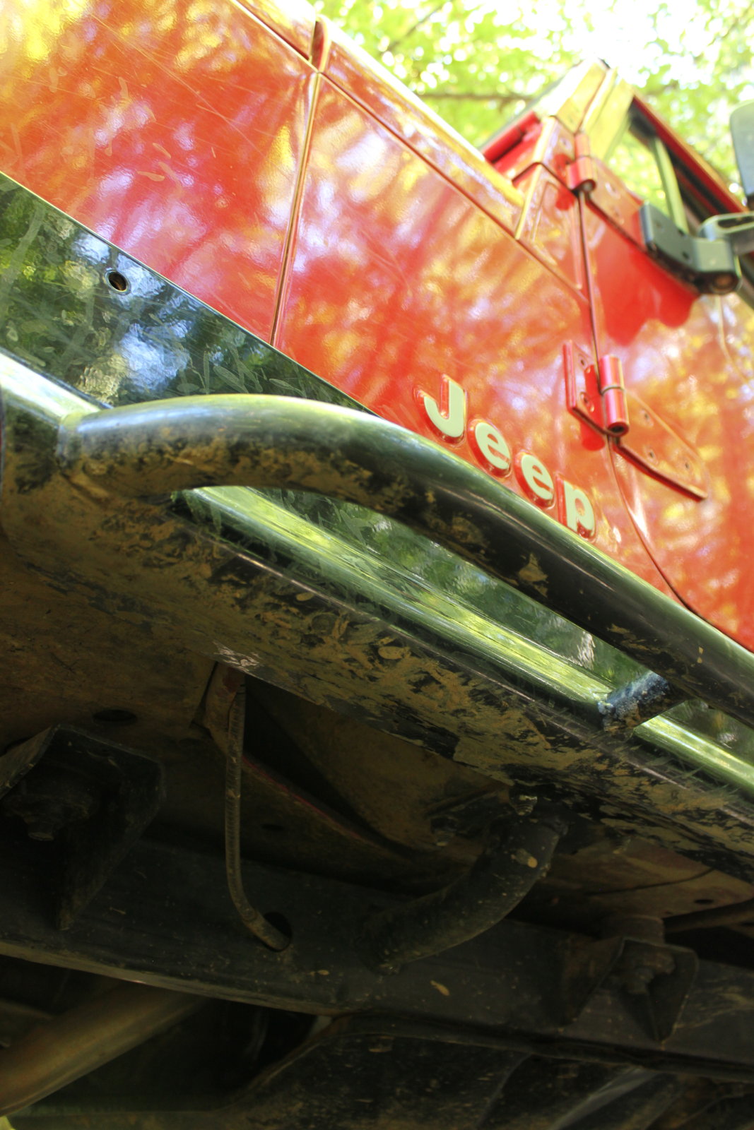

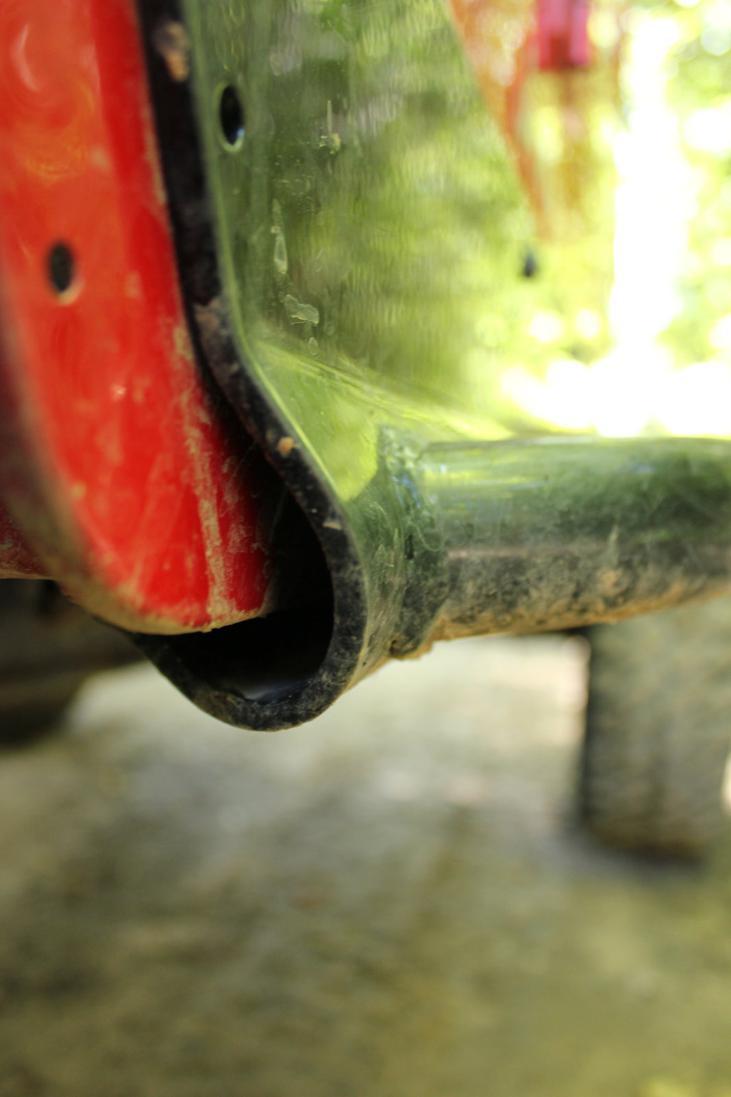

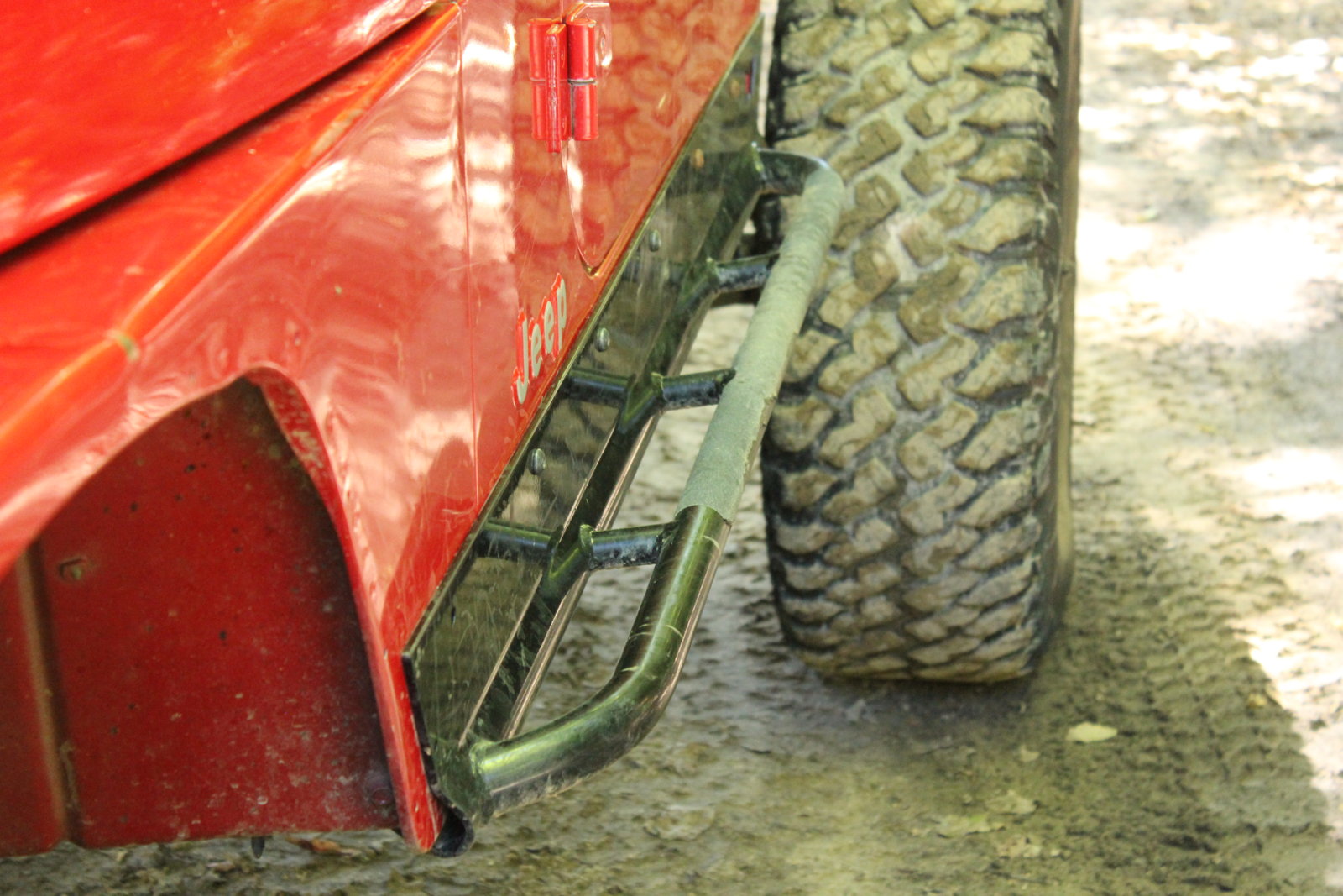

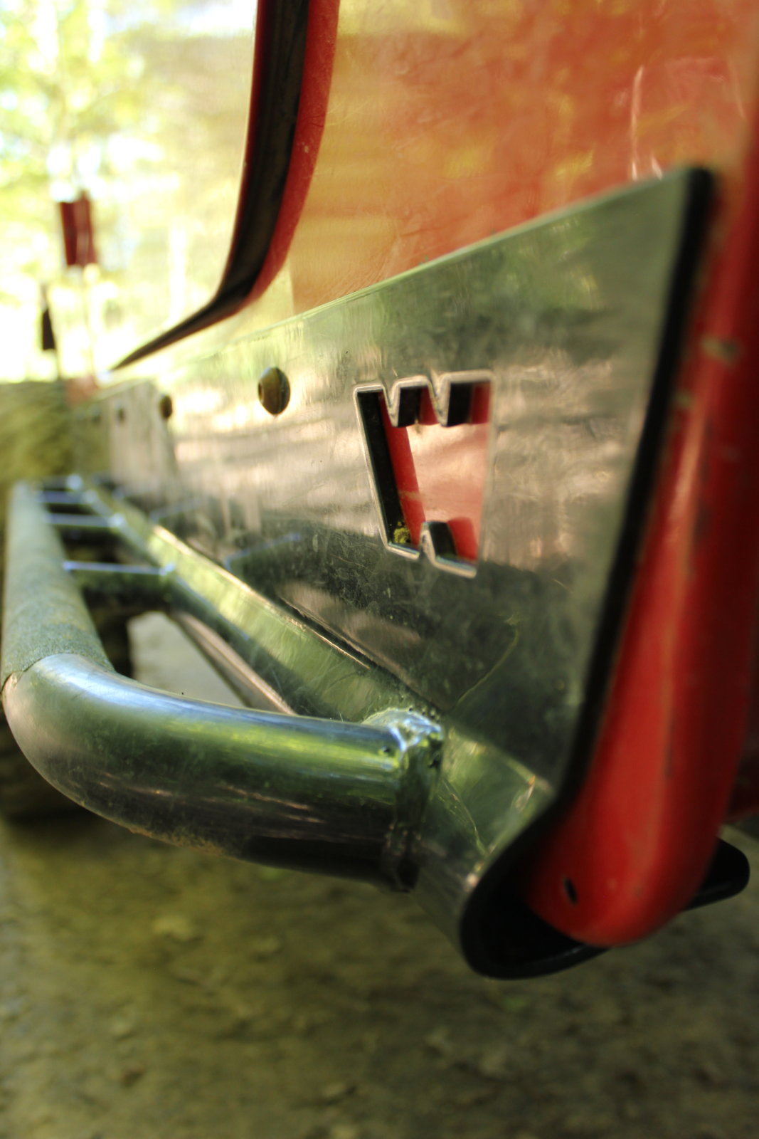

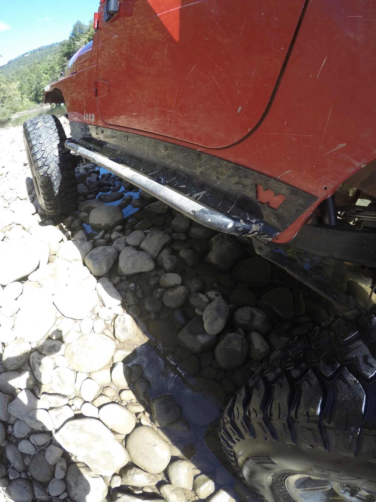

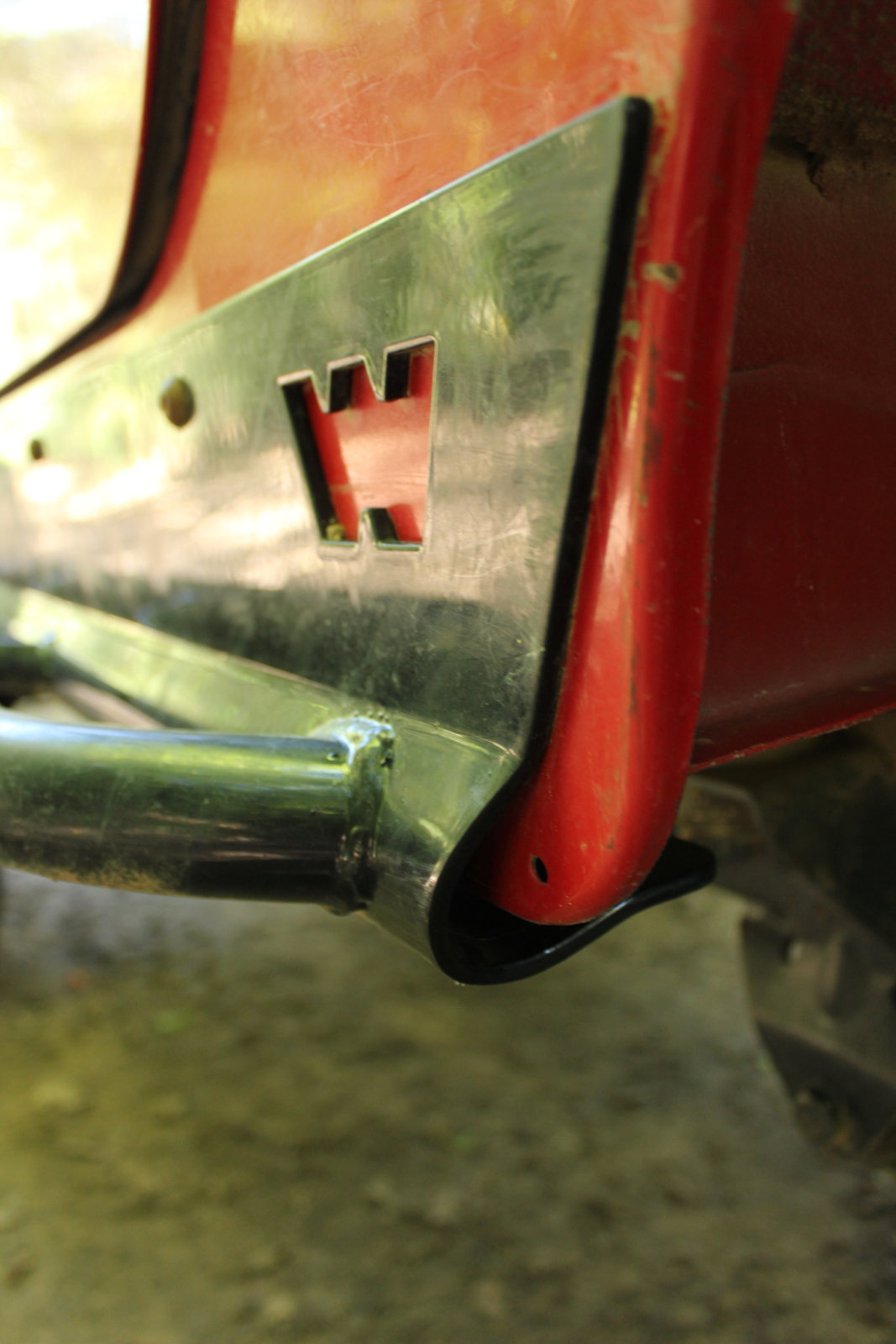

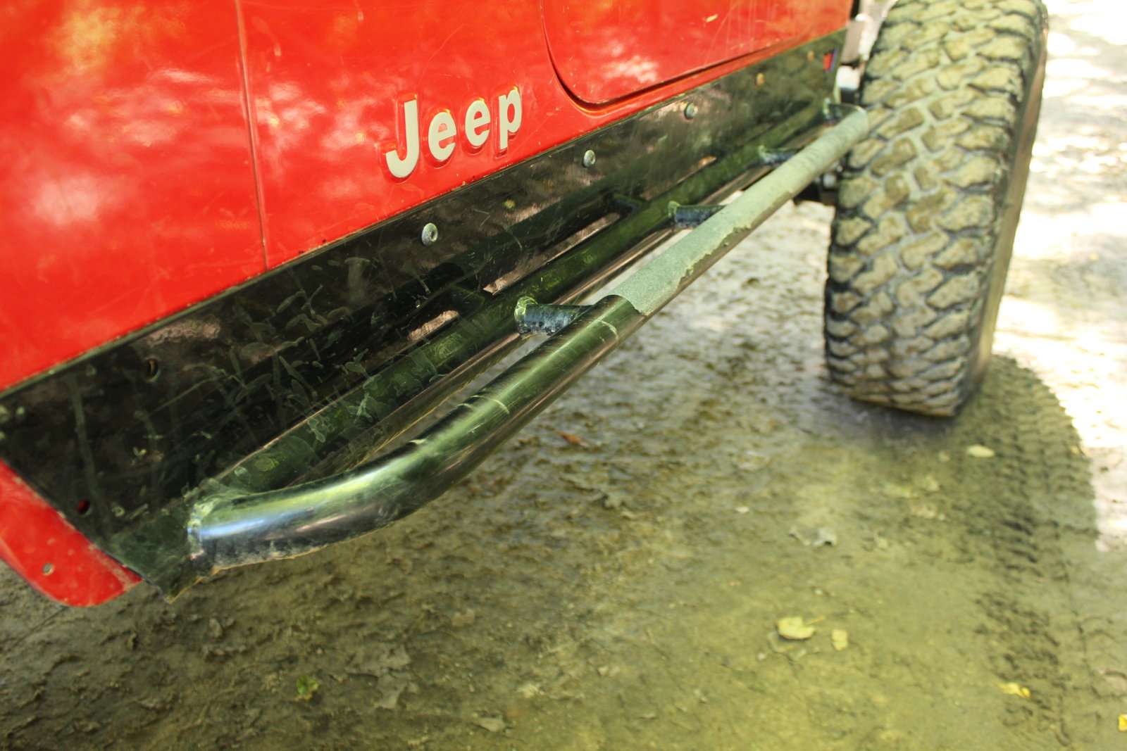

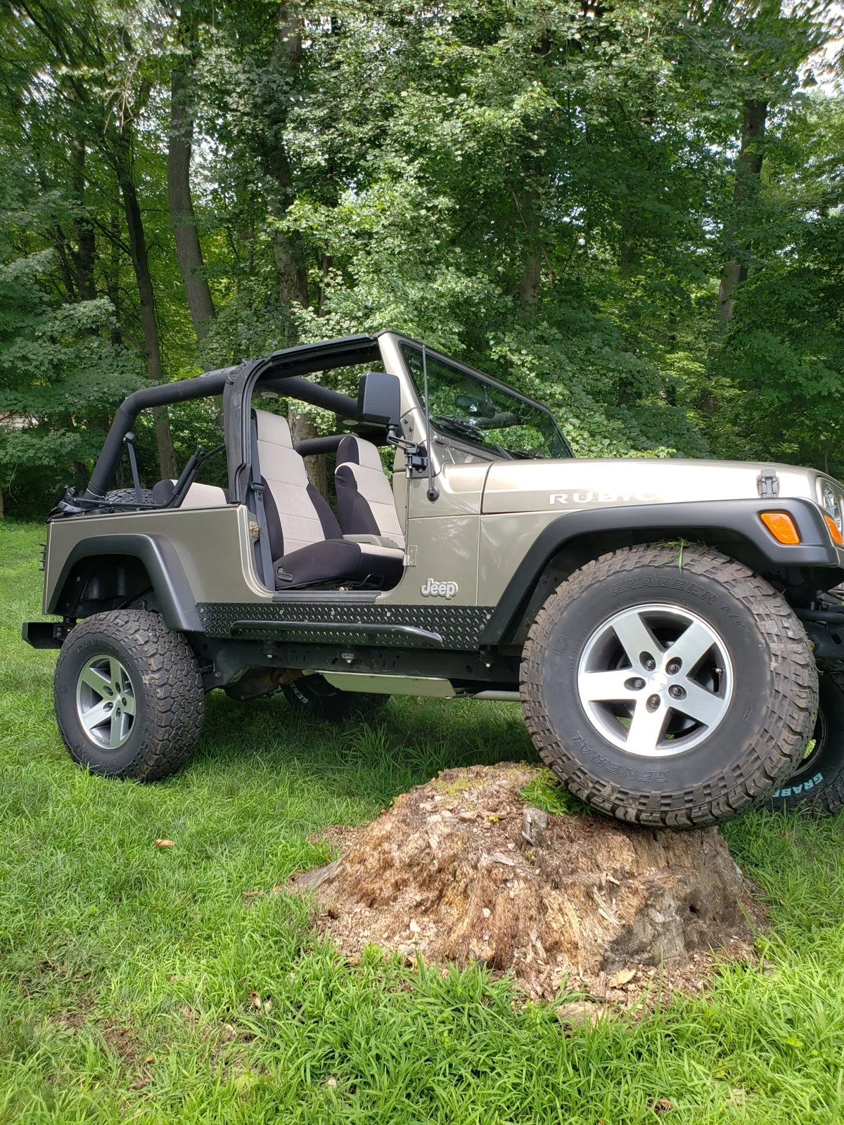

Finally got some high resolution pictures of the Warn rock sliders that are now a little better, a little custom.
As soon as I saw the Warn sliders I fell in love. They are the most aesthetically pleasing in my opinion. I love the lower rounded bevel that wraps around the bottom edge of the tub. The Warn sliders do lack a step which I feel is very important for a lifted TJ/LJ. So I added one to each side and threw some skateboard grip tape on em. They are now the perfect combination IMO. It also protects the actual slider from dents, dings, and scratches.
Check em out.
As soon as I saw the Warn sliders I fell in love. They are the most aesthetically pleasing in my opinion. I love the lower rounded bevel that wrape around the bottom edge of the tube. The Warn sliders do lack a step which I feel is very important for a lifted TJ/LJ. So I added one to each side and threw some grip tape on em. They are now the perfect combination IMO. It also protects the actual slider from dents, dings, and scratches.
Check em out.
View attachment 55799 View attachment 55800 View attachment 55801 View attachment 55802 View attachment 55803 View attachment 55804 View attachment 55805 View attachment 55806 View attachment 55807
Thanks for posting a pic, I've always wanted to see a close up of how the Warn lower bend was.
When you added the step, was paint matching easy? Looks pretty consistent all the way across, nice job.
My TJ is right at the height where I don't necessarily need a step (I'm also very tall so that might have something to do with it) so I like the look of these and the savvy versons.
Reactions: Fouledplugs
Haha! Yes. Finally. That gives a great view of the bend. I would not hesitate to go all in on a pair of Warn Rock Sliders. Thanks much @Fouledplugs.

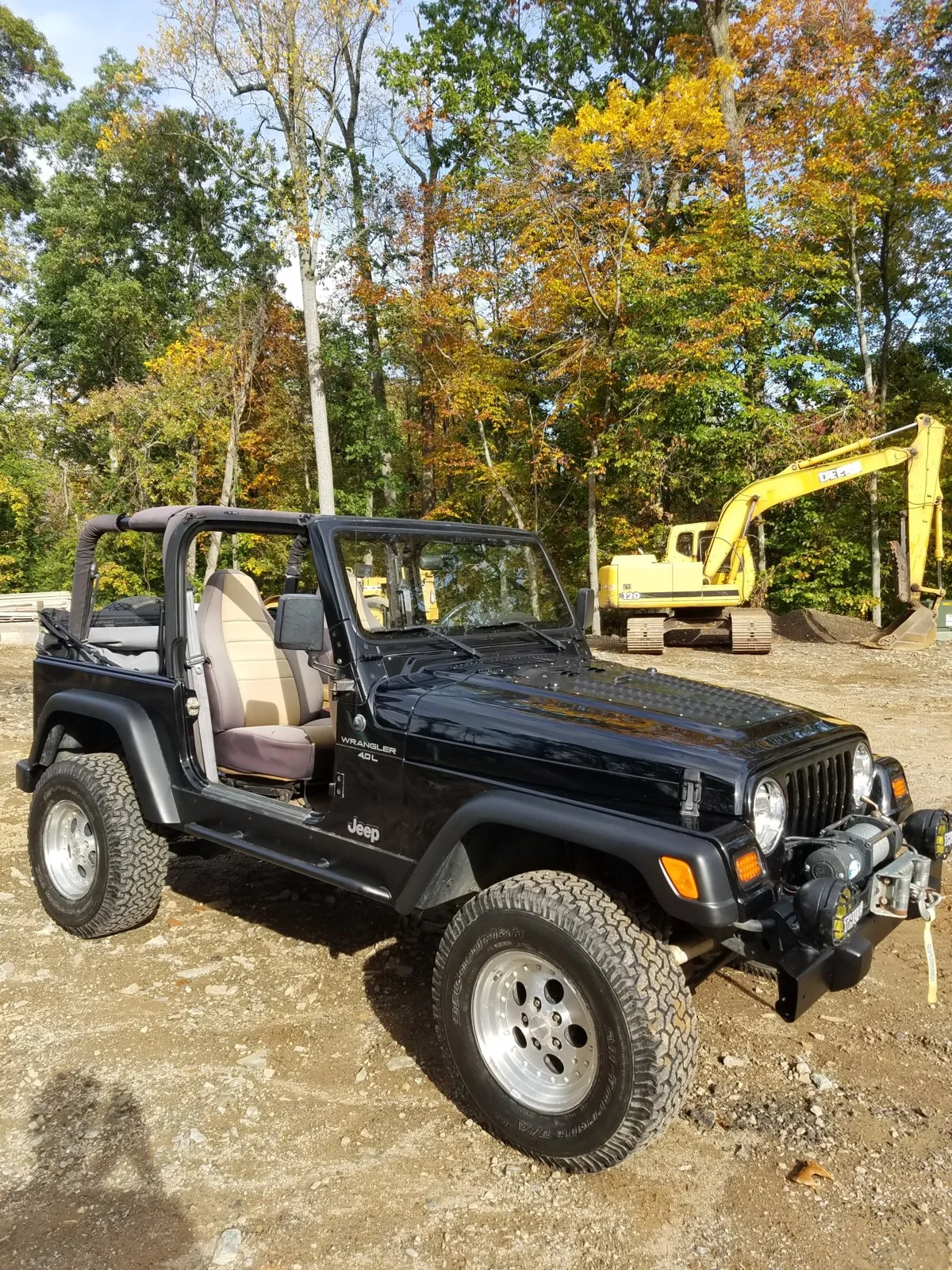

Yea I needed a step being that this one is on 38’s. And then of course needed griptape because its rare to find dry trails in the South.
Did it right, no shortcuts, so had it stripped and powder coated.
