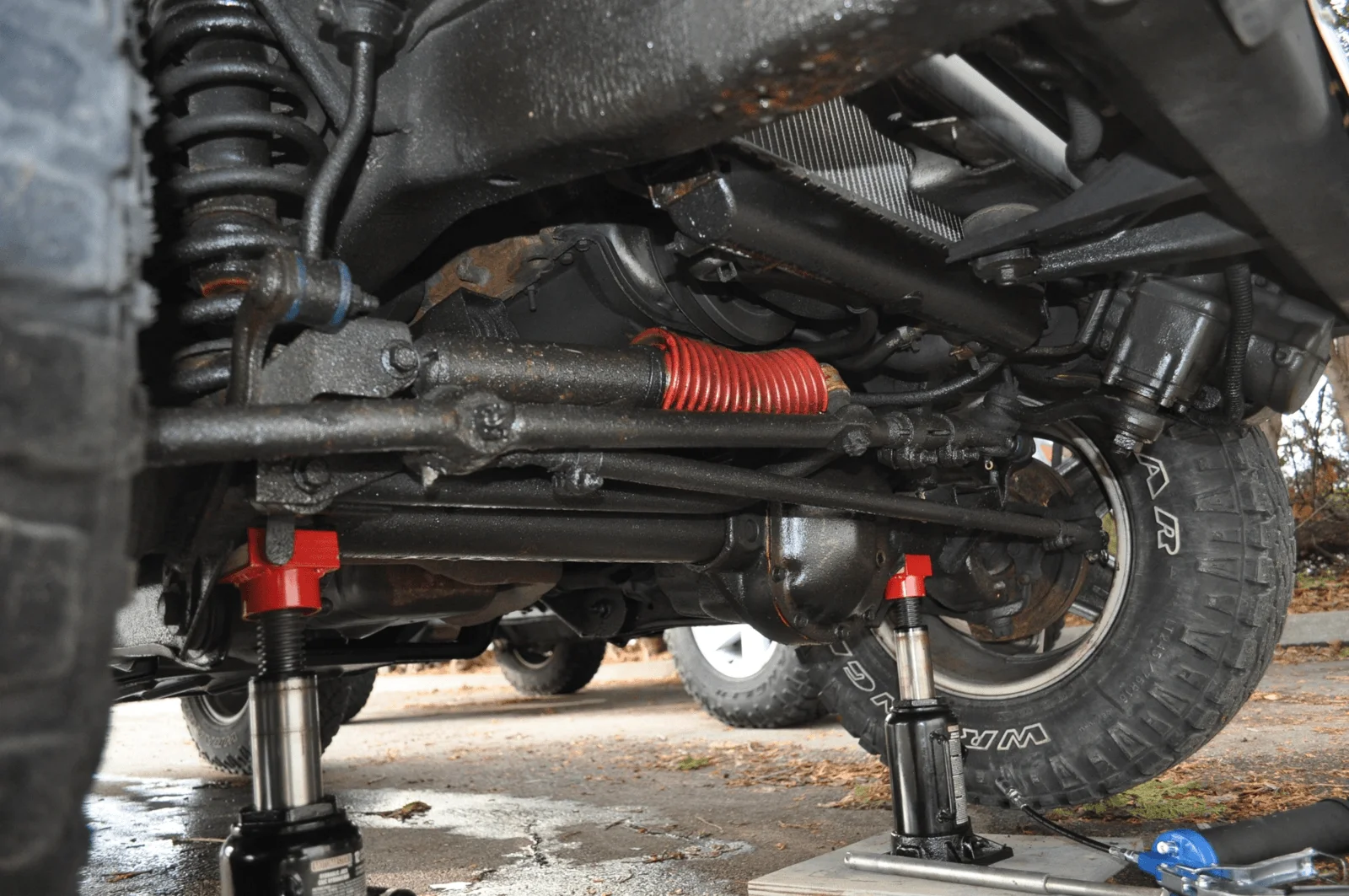

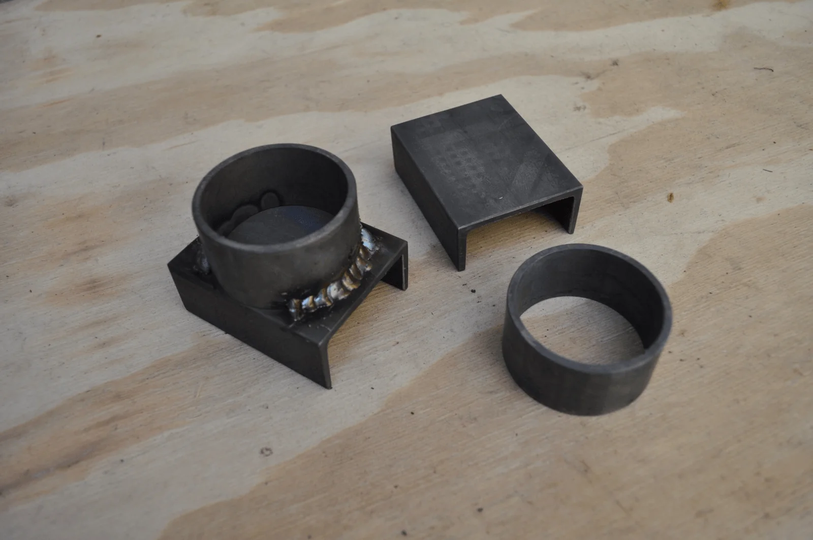

For the front end I use 2 bottle jacks with adapters that I welded up. The axle sits on a couple of small wood blocks.

I like those bottle Jack adapters. I can make some up pretty easily

That's what I've always done in my limited experience. Then I started searching for a quicker/easier way and found some saying you shouldn't do that. I'm going back to my old ways and making some of the bottle jack brackets like PC06 suggested. I put my TJ up more than I have all of my other vehicles I've had combined.
